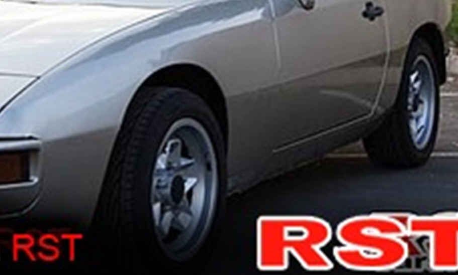

Pix..

wow havent seen those Ronal wheels in a while .....Good old days

Racer so your saying these will fit as is ? I messaged you regarding them.. Thx
Old 05-03-2013, 03:56 AM
Correct, offset looks to be the right one.
