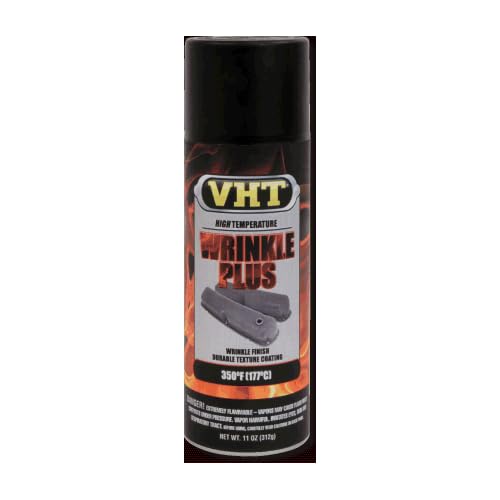

Hey Dano I really like that first picture of the intake. How much did that cost? Cheaper than powder coating?
MPDano 01-17-2012 08:41 AM
$10 for a rattle can, so yup a lot cheaper. I can't remember how much it cost for the Powdercoating but I had a bunch of other stuff done at the same time. Powdercoat will last longer and looks a lot better after time. My Painted stuff has kinda faded.
http://ecx.images-amazon.com/images/...BL._SS500_.gif
whatudrivin 01-17-2012 09:20 AM
Good to know. Thats a nice, cheap touch-up. I really liked the look though. Was hoping it was something that would last longer. I think that with the blue that you have going on makes everything pop. Just have to see how well everything I have cleans up.
