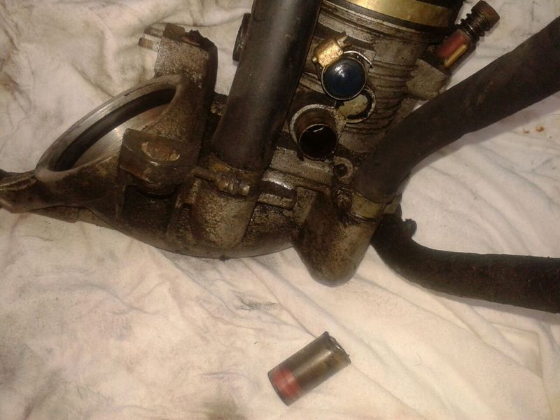

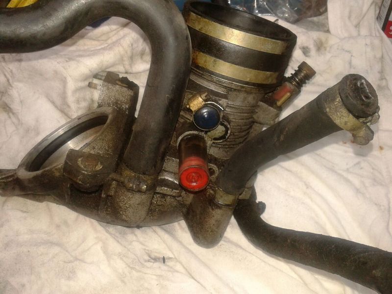

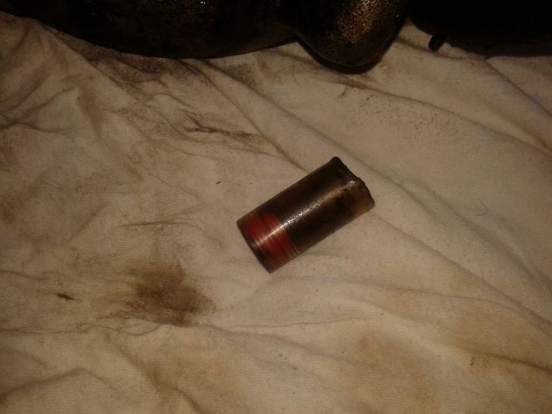

I have pulled the Air plenum and throttle body off of my 84. When doing so I found a large nipple on the side of the throttle body with nothing attached to it. Underneath it I also found a short cap like piece that looks like it may have been attached to it. I have provided picture too. I know how we all like pictures!
It appears that it goes like this.....
Just need someone to confirm what I suspect!
Dan

I would say it needs to be plugged up for sure...especially if there is not a strange little hose that curves down and seems to want to plug into it. If I had mine at the house, I would go out and check it for you. I have an 84 as well. Plug it off and it will run and then do some research as to what actually goes there. When I get mine back to the house in about a week, I'll reply if not already answered. I would use a better plug though...that looks pretty rigged

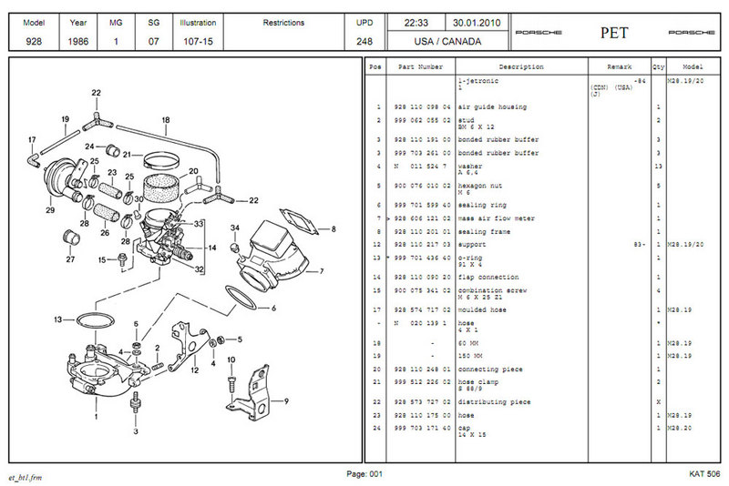

That is I think where the vacuum limiter goes in early cars and where the idle control goes in newer ones. Idea is that if you down shift with the throttle closed the vacuum may be sufficient to prevent combustion and cause a misfire.

Mike is correct, also called a "Decel Valve" and it's purpose if keep from backfiring upon deceleration. My S also did not have one but in order to comply with the Calif Smog Nazis, I got a good used one from 928 Intl and installed it.
That is a "huge" vacuum leak spot so if your going to ghetto plug it. Use new rubber/silicone pieces.
http://forums.pelicanparts.com/porsche-928-technical-forum/588682-vacuum-limiter-decel-valve-vac-route.html

It doesn't appear that I have a vacuum limiter. Maybe it was removed by the PO. I think I am going to plug it up tight, at least for now. once I have her up and running I will see if it makes sense then to install it.

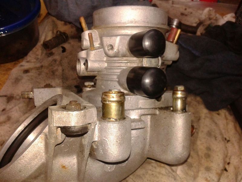

My automatic had some caps on those ports as well. Can't confirm that it was only manuals though.

My 82 auto has those caps. They have a part number I believe, since on automatics they are all capped (I'm pretty sure). I replaced both of mine when I was trying to hunt down a vacuum leak.
928sRUs can provide the factory caps. I don't have an 84, but the one you have looks really long to me. Also, I can't tell if the top one in your picture is capped at all.

Thanks for the Pic Brad. Very helpful The top one on mine does have a cap on it that is in poor shape and has a screw clamp on it. The lower one was just kicking around on top of the engine. I am going to replace both caps.
