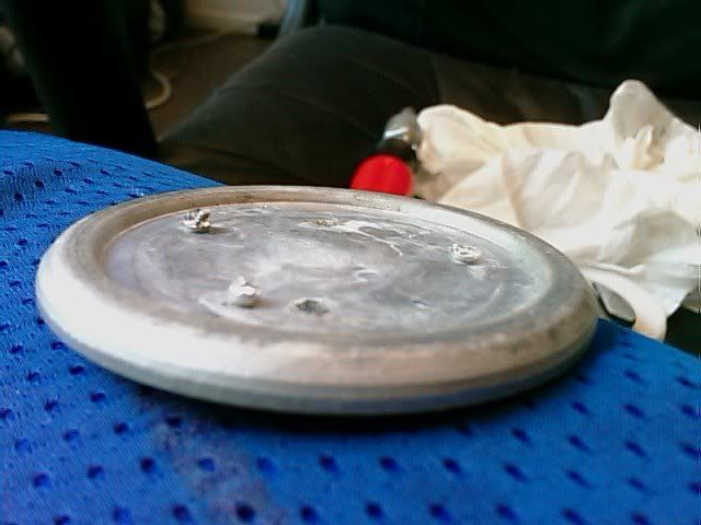

As to the repair, take a look at the back of one of your caps. They're actually not welded. There are 3 posts that hold the ring to the cap. Just have to flatten the posts to hold the two pieces together.

Hurm... I see the three post. (I'm using my old center cap) How do I get the ring off though? Can I order just an attacthment ring, and snap it on there?

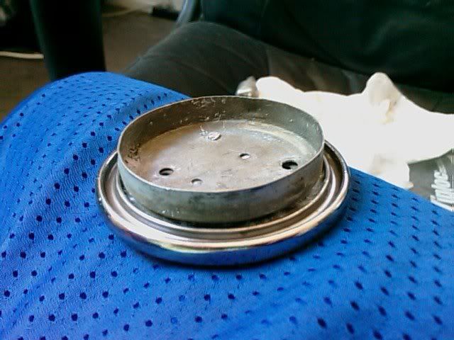

I would doubt you could just order the ring. I would have to assume it comes as one piece with the cap, but I could be wrong. I think steve911 was trying to tell you to carefully remove the ring from the junk cap and then try and snap it onto the good one. To ease it on, you could probably pinch the posts a little bit to make them skinny enough to mount the ring. Once it's on and over them, carefully flatten the tops of the three posts to secure the ring onto the good cap.
How do you get the ring off of the old cap? The same way. Pinch the three posts until they're skinny enough to slide the old ring off. There ya' go. Steve911, correct me if I'm wrong here. I'm sure you might have a better solution......

Yes! I did it. Sorry to the so-so pictures. I took them with my phone. Now to Ebay! Thank you for all of your help guys! In the second picture, the ring is on really tight, the two holes where it looks loose is were the center cap tool removal goes, lol.
