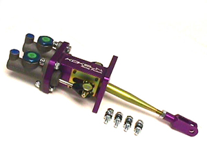

Has any one tried an adjustable proportioning valve such as those used on a track car? I beleive they use a twin master cylinder, like Kokeln makes. I was just curious as to how hard this would be to install, or if it would be worth it for light track use. I have seen some pretty cool setups on race cars, that have two gauges with a knob to adjust the pressures. It just seems like it would be the ultimate setup to solve brake bias problems, but it may not be worth the trouble to install if it is only used once or twice.

There are two ways to get adjustable bias.
The cheap and easy way is to put an in line manually contorlled proportioning valve on the rear brake line where it comes off the master cylinder. Willwood has a decent one.
The Expensive way is the Kokeln dual manual master cylinder with a bias bar. This is cockpit adjustable. The bias bar is the better way to go (because it literally balances brake line pressure at the cylinder rather than limiting pressure in a line) but is many times more expensive than a simple proportioning valve, and requires much greater leg effort.
The proportioning valve can also be moved to the cockpit but it requires rerouting the brake line for the rear brake circuit through the passenger compartment.

How much is the Kokeln unit?

$1500
http://www.lindseyracing.com/944sus7.htm

Thats definately the expensive way. Do you have any experiance with it? It looks like anyone with some time, experiance, and access to a decent machine shop could make the braket and buy the master cylinders. Or maybe even modify a wilwood or other comparable unit to work in a 944, although I'm not sure that they are any less expensive.

I've seen it in action. I've never installed one, and the guy that had it went from that to a stock 968 MC and booster on his '86 951. He has Big Reds up front.
Anyody with the tools and know how could build it. It isn't a complicated piece. You'd definitely want to see one before you tried to make one though.
