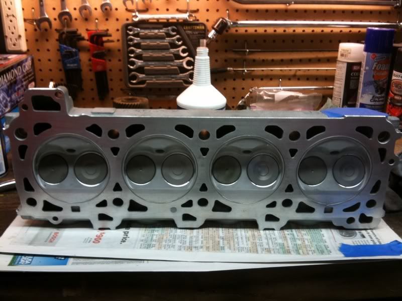

The o-ring is little more than a piece of stainless wire. The cylinder head or block (not both) must be machined with a receiver groove.
This is an o-ringed head
