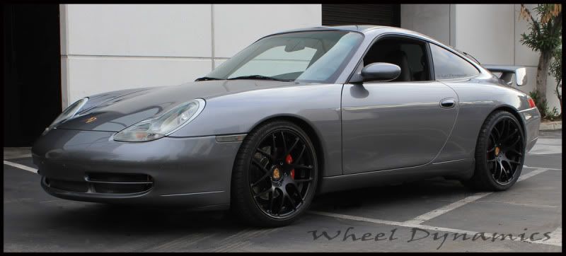

better luck today.

looking good...i went ahead and ordered the H&R springs, after seeing yours i am glad i did. what size rims are you running? (NEVER MIND: I looked in your garage after I posted this) I ordered these rims and tires from wheel dynamics as well.

Can't wait to see some photos on your car... please do share and send a photo to us too... info@wheeldynamis.com
