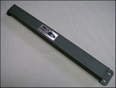

Old 12-18-2008, 02:22 PM
Moderator
Bill Verburg's Avatar
Join Date: Dec 2000
Posts: 26,558
Originally Posted by cgfen View Post
2. Fabricating a bar that runs under the seat pan to wrap the sub belt around.
I'd like to try # 2, but am getting conflicting information as to whether or not i can use the seat mounts to attach the bar to, or if i have to sandwich the bar between the seat mounts and the floor pan somehow.
I run in PCA and POC events.
The car is a 96 4S
Looking forward to your thoughts and or photo's if you've gone down this path.
thanks
Craig
No need to fab, though you could. BK R-9031 should do you.

Old 12-18-2008, 03:31 PM
cgfen's Avatar
Join Date: Apr 2007
Location: Vista CA
Posts: 300
this one?
if so, that looks like it will work.
I can sandwich it between the mounts and the sliders or the sliders and the floor pan depending upon clearancing.
hmm some rectangular tubing and a few endplates = not much $$$$$$$$$
time to stop putting off buying a starter boy MIG welder methinks.
thanks Bill.
Cheers
Craig
