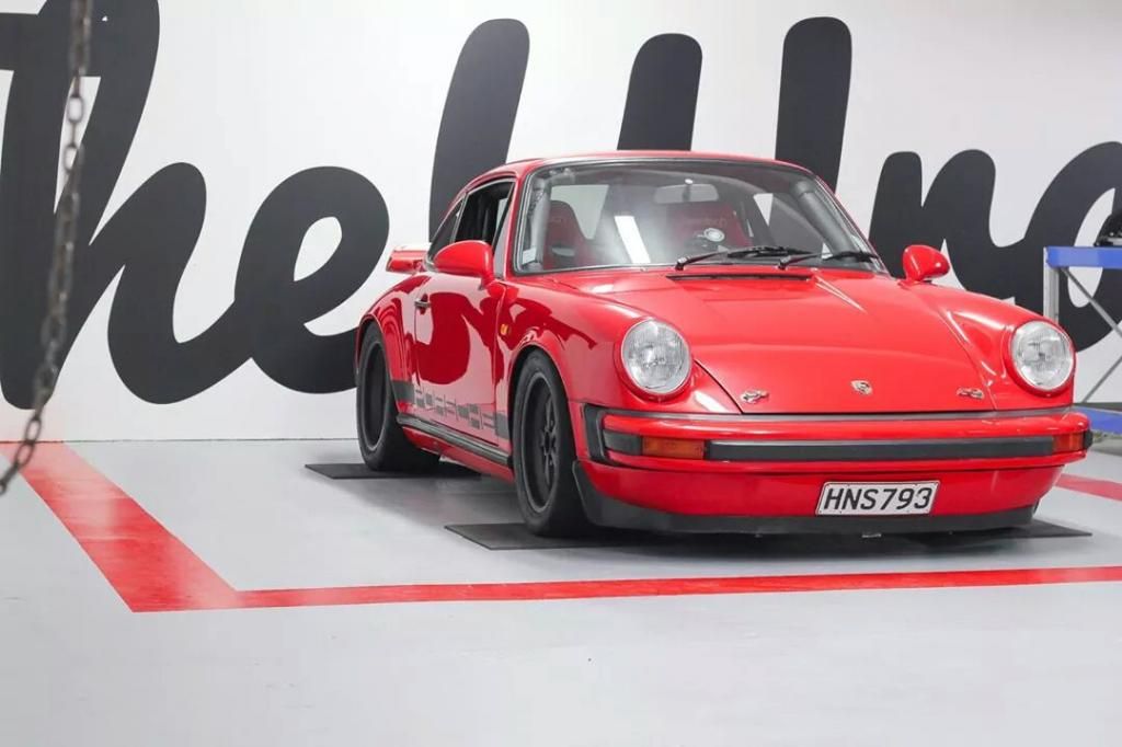

Heres mine on 116x7 and 16x8 fuchs no spacers. TOYO R888 225/45 245/45
I believe these are the best size for the rims.
