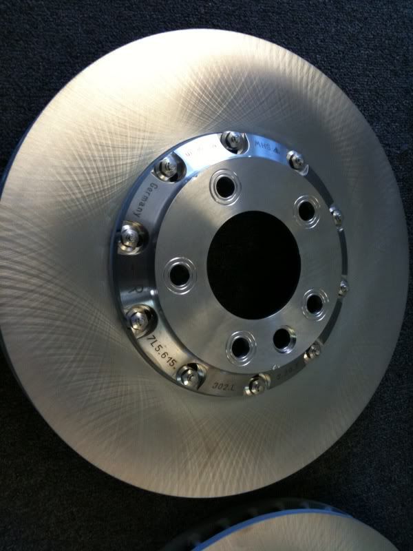

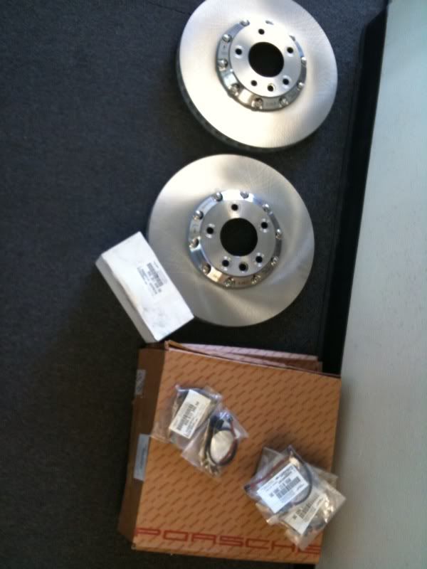

You can all be lucky that you don't have the Turbo S brake package...big $. The rotors retail at over $700 each. These are going on a Turbo S with 60k miles.

U-oh . . .that last pic really shows some machining ridges. You had better have those polished out before installation.
