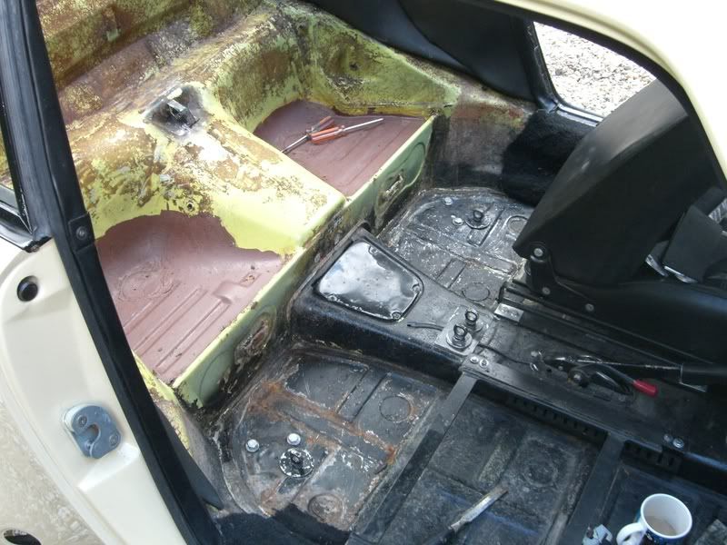

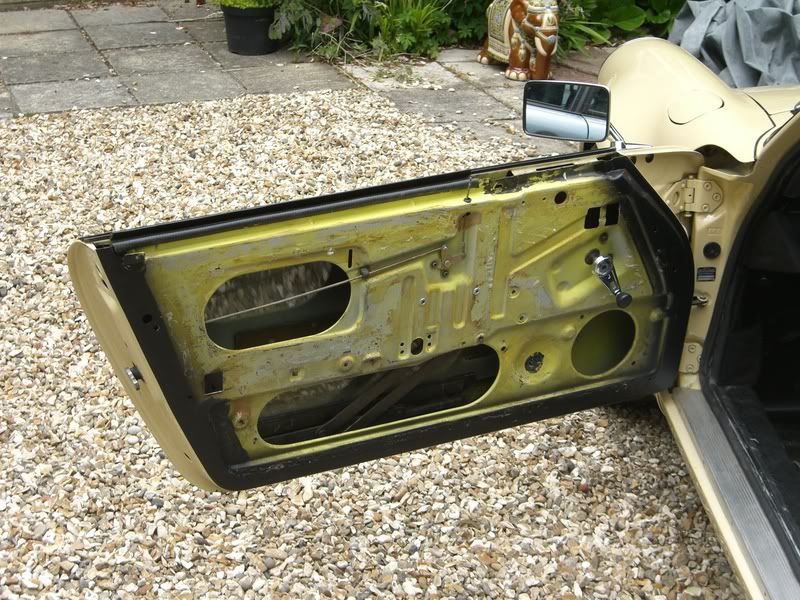

Job 1.
Strip out cage and chip out balance of gunge from passenger footwells in preparation for some Por-15 & Dynamat as a concession to my sons' hearing.
Job 2.
Trial fit old Scheel bucket seat - Mrs G likes it
Job 3.

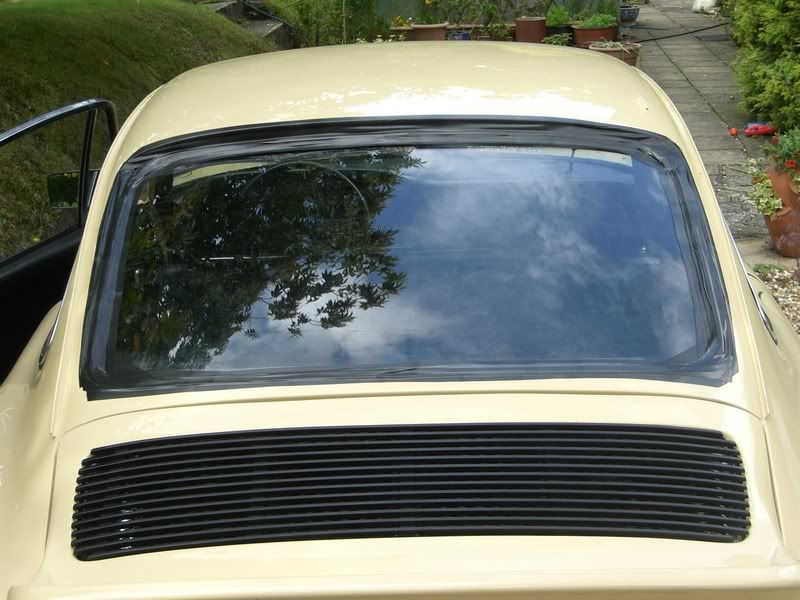

Remove window frames & door handles then strip black paint back to original anodised finish.
Job 4.
Fit Euro indicators
All in all a very productive weekend
Martin

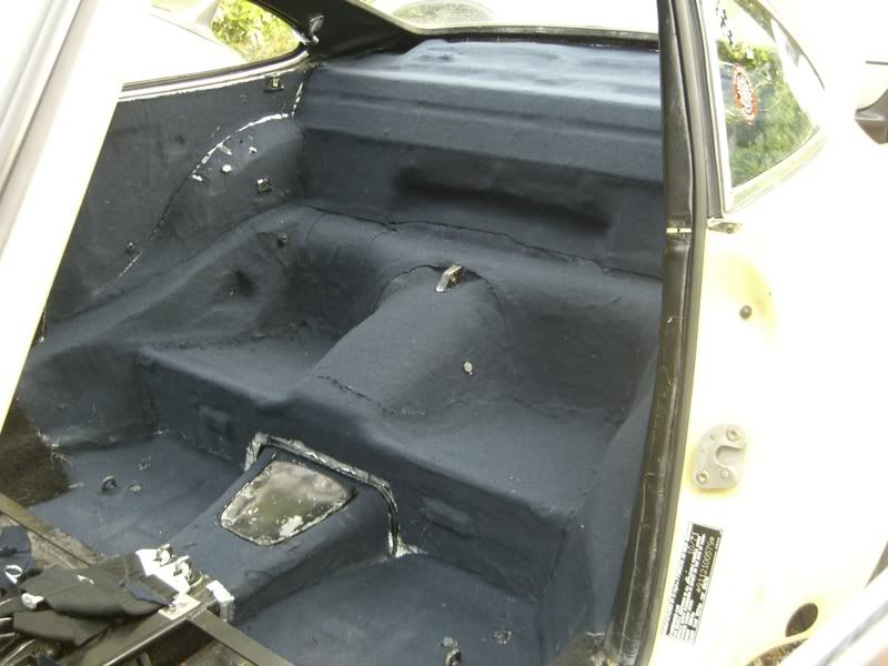

A nice day for painting
Pre POR-15
Post POR-15
Next stop Dynamat
Martin

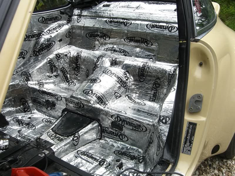

Today's job
36 ft2 of Dynamat went in today - horrible stuff to install.
Martin
Congrats - you just added 24.5 lbs. of weight to the rear of the car... or more if it was not the original Dynamat.
The car will be quiet from that area tho.

Congrats - you just added 24.5 lbs. of weight to the rear of the car... or more if it was not the original Dynamat. The car will be quiet from that area tho.
(a) All done in the greater interests of my 10 year old son's hearing and if that aint enough there'll be more going in the front and where-ever else I can squeeze it in.
(b) Having just removed the Porsche installed 'hardened toffee' that the Dynamat replaces, I would speculate that the weight gain isn't as much as you might think.
(c) Otherwise have removed a 'very heavy' 80's Recaro and replaced it with it with a very light 70's Scheel that must be at least half the weight - one down one to go.
I guess I really should have weighed the car before I started coz who knows (in my dreams) I might just have incurred a net weight saving but certainly nothing that a Big Mac and Supersize Frys won't sort out
Martin

Underlay
Some nice 'light' underlay glued in today - next stop RS Carpet.

Shiny bits
Car now watertight (I hope) with new front / rear shiny trim installed and some rubber hold-down straps.
Now I can finish the lightweight carpet.

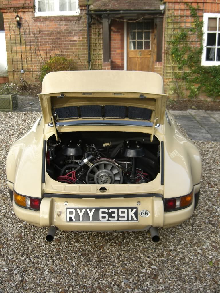

72t Update
After a 3 month break she's back home:
The car was a pig to drive below 80 mph (overfuelling, missing backfiring etc etc) after which it went like a scolded cat - great for the track but not much use on our great British roads so decided to return the engine to a more 'user friendly' 2.7RS spec.
Work undertaken by Bob Waston Engineering:
- remove the 'raised' 965 injector stacks (poor mans high butterfly)
- relocate stacks back to factory position
- reposition injectors back into the heads
- rebuild RS spec MFI pump
- replace worn cams & rockers with S cams & 930 rockers
- gas flow & twin plug heads (for future use)
- skim barrels and raise compression ratio to +9:1 ish
- new rings/gaskets/chains/studs etc etc
Bob's somewhat conservative rolling road shows she is now producing 220 hp which is consistent with a good 2.7RS spec engine and although I haven't had an opportunity to test her legs the car is transformed, pulling cleanly from low revs and spinning very quickly onto the S cam - so far I'm delighted with the new engine and at last can actually enjoy driving the car below 80mph.
Next stop will be to complete the interior, recover the Scheels, refurb the factory 9"/11" fuchs and then negotiate the divorce.
