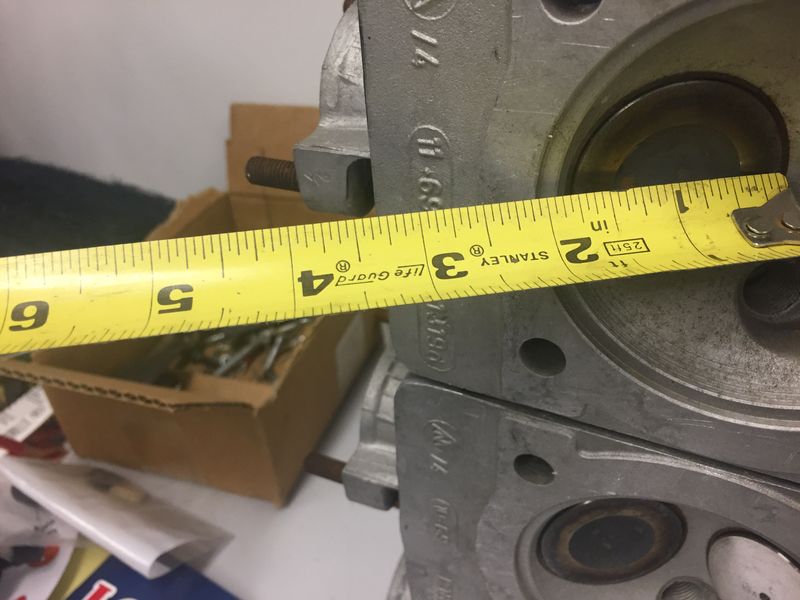

I just pulled some motor parts that have been in storage since 1999 and could use some help determining a fair value. This is what I have.
The pistons are mahle M078 marked 80ZD3(used and soda blasted)
Camtowers are 901.105.111 (911 E mpi) with RSR sprint CAMs with 03 stamped on the ends
S valves ported and polished part number 901.104.306.2r dated stamped 10/69 and 11/69 And marked k1819d
I also have all four pieces of the CAM chain covers. I believe these are from the 914 6 parts that were left over
Any advice is greatly appreciated, i hate to think of these sitting in my garage for another five years
Todd

Pistons and cylinders look like 2.0L 911S. Take a pic of the underside of the Piston crown to confirm.

I believe that they are 911 e pistons with even though the valves are S valves. Pic attached. Thanks for your help!!

2.0S pistons from a 69S. Do you have a full set there or just the one?

Yes I have all six pistons/cylinders and both cam towers with cams
