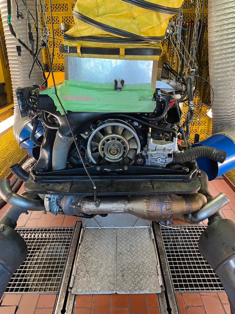

Hello Guys, I will share with you reliable information about how the stock 964 Turbo reacts to increasing boost. The measurements were made on the Maha dynamometer and the measurement itself lasted about 20 seconds under heavy load, which is comparable to the conditions on the road of an accelerating car. The power measurements you do in America and which last 5 seconds are unreliable to me because they have nothing to do with real conditions and the load to which the car is subjected. Maybe it works for you because you simply don't drive at high speeds because you have nowhere to go, in Germany we drive these cars at 300 km/h and it takes a long time. Returning to the measurements, one measurement was made at 0.7 bar and the AFR at 6500 rpm is 12:50. The next measurement is 0.9 bar and above 5000rpm it is already lean. The next measurement is 0.98 bar and at 6000 revolutions the AFR is 13:50 which, as we know, is unacceptable. What's interesting is that this stock motor produces almost 580NM.
Despite air blowing onto the intercooler, with a higher boost the intercooler got very hot. Cooled cold water spray was also used for measurements

Running a long dyno run, as compared to a shorter one, helps mask things like heavy engine or driveline components. Additionally, the only time you spend that much time in one gear, is potentially in top gear. That means you are ignoring all the gears below top gear. There is a reason why most dyno acceleration rates are set where they are. On most engine dynos you can set the rate of acceleration to what you desire, within reason, but you will find that the power levels will show an increase on the slower acceleration rates as opposed to the faster ones. And for tuning you want to get as close as possible to what the engine will see most of the time.

If the engine does not generate any problems under such a heavy load in the highest gear, it means that there will be no problems in lower gears its simple.

An accelerating engine (full load) will require more fuel than at steady state (full load). Therefore for tuning purposes an engine that accelerates quickly (as in lower gears) will be better tuned than going very slowly or steady state. If all you want to do is show hp, then it does not really matter.

both of the best German tuners do things completely differently than you wrote. As I wrote earlier, a short measurement does not reflect what actually happens when accelerate on the road.

If they tune with a slow and steady acceleration rate on a rolling road dyno only, then they are far from the best tuners. Like I said, the only reason would be to show high hp numbers. I suggest you go back to those tuners and ask them how they tune for acceleration in lower gears and part throttle acceleration.

As you can see here on engine dyno they tune
