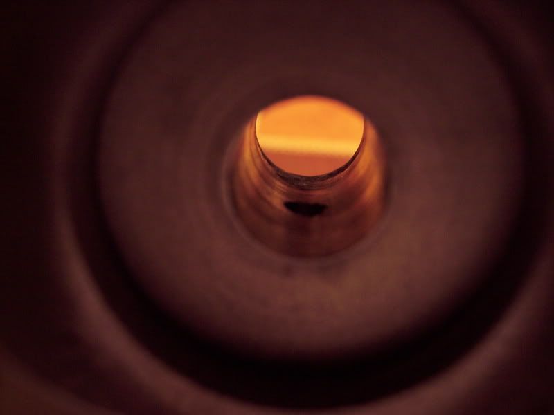

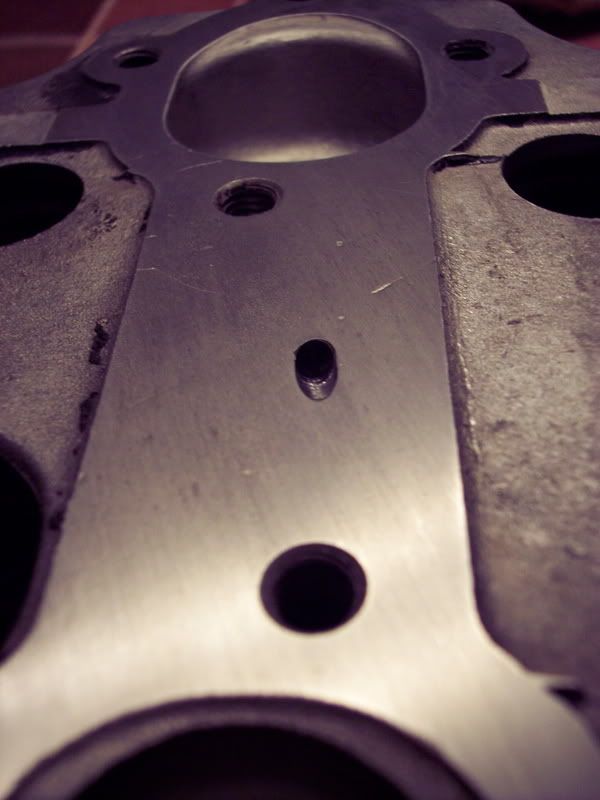

Here's the 935 exhaust guide oiling mod on my latest project.
75 930, 76 930, 83 SC EFI turbo

Dynamohum's Avatar
Join Date: Jan 2008
Location: Midland Ontario Canada
Posts: 173
Very nice,
Care to share how you came up with the angles?
Thank You for your time, Paul. We do because we can.

I think the angles are there to clear the studs, then a passage is drilled to intersect the exhaust guide about mid point for direct oiling.

I was always curious about that 935 exhaust guide oiling mod. Is it just a gravity feed down to the exhaust valve? Any change to the valve stem seal? Is there any downside to this mod? Increased oil usage? Smoking out the exhaust pipe? I remember a different type of valve guide with a lip, maybe just to mark the difference in clearance.
It would seem that the oil would end up in the exhaust port, could that cause a carbon build-up issue? What is the recommended hole size to control the flow of oil?
