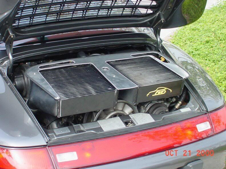

The proto coolers are no doubt great, i've also seen evidence that they perform too, how much are they? They look great too

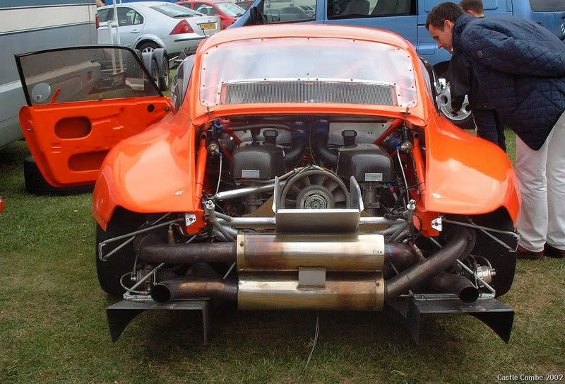

Wouldn't you just love to get your hands on a Secan like this one though
This is one of the FVD style coolers that have been proven to be worse than stock, these really are a complete waste of money
I tried one for size on mine before i did some research, it didn't fit under my stock tail anyway so i didn't buy it, thank god....

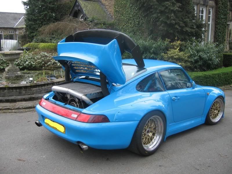

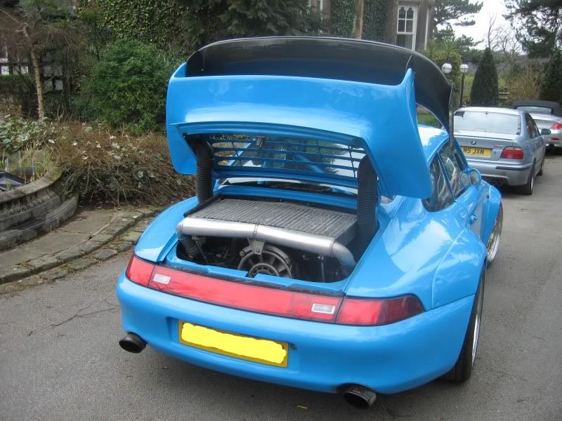

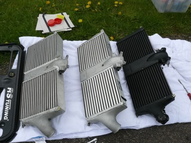

Ok, here are some better shots of the race bred GT2 Evo Secan, these are like gold dust and cost more money than is sane. If you race your car though this would make the difference, it's all well and good having a powerful car that can do great 60-130mph times, hell mines one of them, but having 24hr flat out race staying power you have to go with a Secan
The Secan coolers that RS tuning fit to their road going 993tt's are a bit different, they look very similar to the stock coolers, but you can see in this picture that they have a very different core design, and the fins are really thin and tightly packed. The Secan is on the left, an after market one with Marston cores in center (Marston also do aerospace coolers although they are not as good as Secan), and a stock one on the far right.
Close up shot of a Secan core
Jonathan.

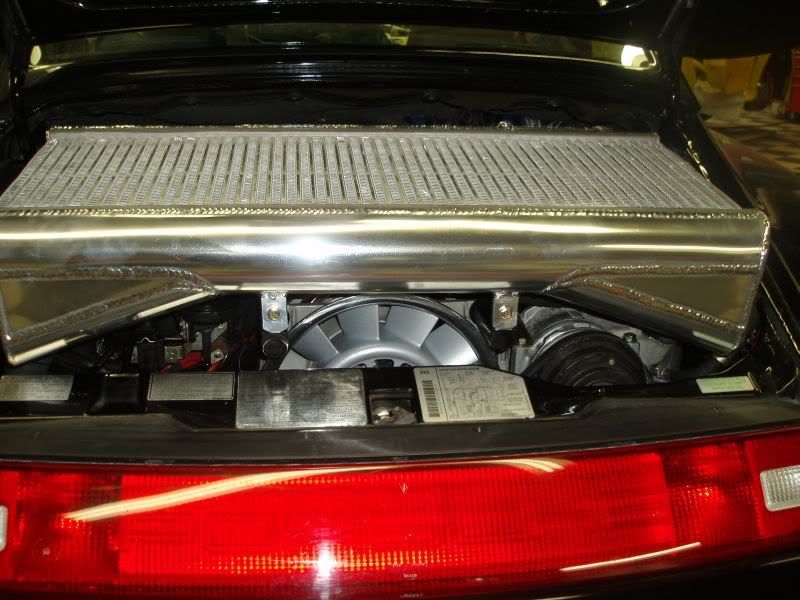

That Secan one looks the goods, but couldn't justify the cost
From what I've heard, the Proto units run about $3.5k. Still a bit too much for my wallet.
The Secan design looks relatively simple. I'm sure a good fabricator can make one at a fraction of the price, even with a high quality core!

Well that's where the cost is on the Secan unit - the core. But you could easily copy the end tanks and layout i'm sure.

The layout of the "stock fitting" Secan in the pics above is exactly the same as stock, tested back to back on the day of that photo with the stock unit, both times run up to 180mph and the ambient and intake air temp logged, this was the result
The ambient temperature for the stock test was around 18DegC and the maximum stable full load intake temp was 54DegC
The ambient temperature for the Secan test was around 16DegC and the maximum stable full load intake temp was 33 DegC
That is a BIG difference, same car, same day, same fuel etc etc. When you think that the Motronic ECU pulls 4.5-degrees of timing and some boost at 54-degrees this is a drop of about 30hp. At 43.5-degrees the ECU pulls 2.25-degrees of timing, so you can see that getting the intake temp down, certainly with Motronic, makes a big diference. For you guys running other ECU's with fixed boost won't be as affected, but you are wearing your engine out quicker than you would with a better intercooler.
Just for reference guys, the stock looking Secan is around $16k, it's the big "front to back" style Secan that is $30k. Apparently the $30k unit will keep intake air temp within 20-degrees of ambient, the $16k unit will keep it within 25-degrees of ambient.

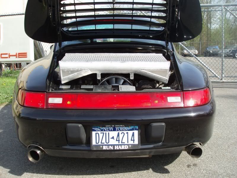

The OEM cores are too thin for my liking. 4" thick would be better.
12" x 10" x 4" for each core would be nicer
Sorry to keep raining on the parade-- but-- 993 TT OEM intercooler is almost certainly far superior to anything you are likely to come up with.That is FULL STOP.Factually cheaper than custom to acquire and regardless of superficial measurement there is a lot more to intercoolers thn the obvious.
If you are going to TT set up the OEM 993 TT unit is an easy way to go.

I would use the 993TT OEM IC, however, it doesn't mate up to the Carerra Throttle Body easily

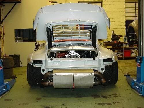

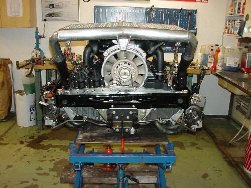

Gabe, you mentioned mounting the intercooler in the back of the cab etc earlier, thought you'd like this pic, i've send you pics of this UK 935 before but pics are always good
