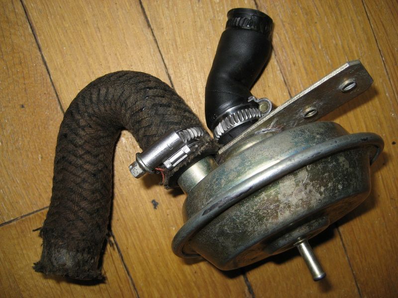

Do I connect the two hoses on the back of the decel valve (#9) to each other or do I cap them both off? I removed the valve because it's faulty. I also removed the AAR (#4). Now the car won't start. Is it because I capped both hoses?

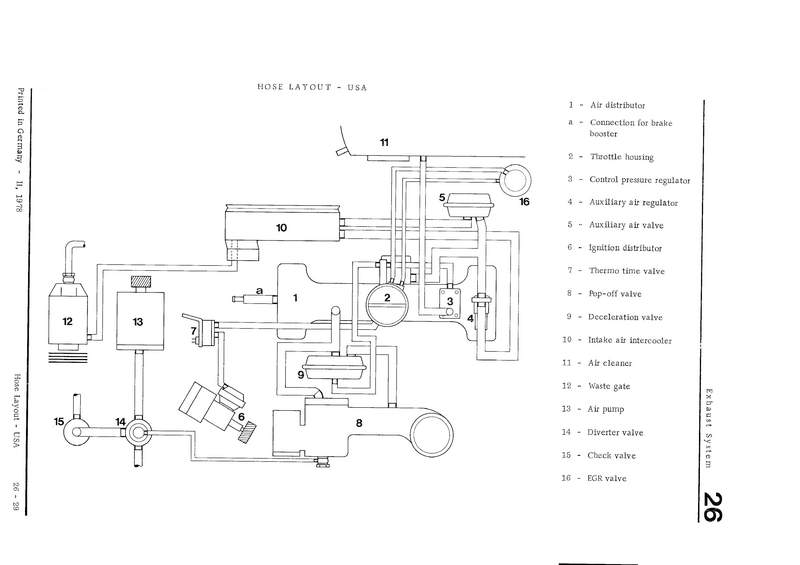

Looking at the pic above, my car does not have #s 4, 5, 7, 9, 13, 14, 15, and 16

When I recently removed my decel valve, I removed all the hoses and capped-off all associated ports (including the tiny one on the throttle body) . . .

That's what I just did, along with the AAR and it won't fire. I crank it and it catches for a second and then dies.

cap all the connections that went to the decel valve.
since you removed and capped the cold start aux airslide valve you'll have to hold the gas pedal down about a 1/4" or so to let enough air in to start the car and keep it running.
you could install a porsche 944/BMW 320i plastic heater valve in place of the aux air slide valve. it fits the hoses perfectly and with a long cable would make a nice hand throttle for CIS.
all those silly throttle body air bypass devices do the exact same thing as holding the gas pedal down just a little bit beyond idle speed at certain times like decelerating (the saucer shaped deceleration vacuum limiter valve and saucer shaped AAR valve used on the 79 and earlier 930) so nitrogen dioxide emissions or NO2 are reduced and or at cold start ( the cast aluminum auxilliary air slide valve or whatever you want to call it today) so the motor will keep running without you feathering the throttle when it's cold.
they do nothing more than that... totally optional.

I know most want to remove the throttle bypass valve as they think of it as a smog device.
I have noted this before but it also helps minimize turbo stall between shifts in a way similar to the compressor bypass valve dose.
This helps keep boost up between shifts and makes things easer on the turbo shaft and bearings between shifts.
It also adds a little safety as if the CBV fails you will not be as likely to snap a turbo shaft.
The AAV is just a cold start feature.
If either are removed, yes, block them off and use clamps to prevent blow off.

...and you can just not let your foot off the accelerator all the way between high speed shifts and do the exact same thing without being married to it if you believe that theory.
along with that, by removing this emission device you get quicker deceleration of the engine during low speed around town gear shifts so the engine rpms match perfectly during casual upshifts making pleasent smooth driving.
and by golly you'll also have a much more stable idle speed with one less artifact from the early days of fuel injection thats just waiting for you to close the hood so it can play vacuum leak and mess with you.
