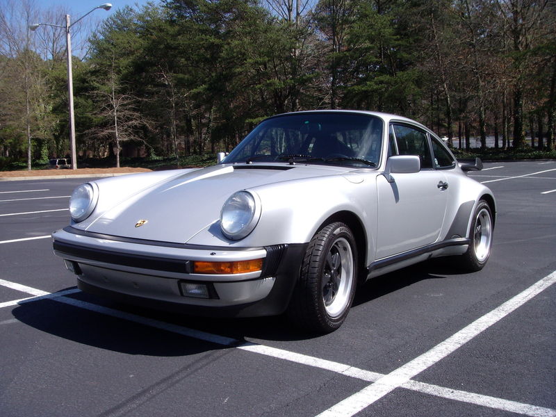

Obligatory pic.

Nice car!

your car is beautiful. i have the same color. metallic silver/black interior.

oh and i am partial to your car
