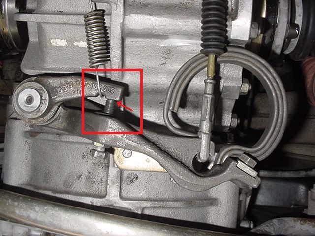

clutch not holding anymore. what clutch to buy.
87 930 just did bolt on upgrades and clutch won't hold in 3 and 4 gears. Should be around 310-320 whp. Is there an adjustment to check or do I need to install a performance clutch kit. What kits are good?

Check to see if there is a small gap between the clutch arm and adjustment bolt. adjust mine so it's just barely touching.
The stock clutch should be able to handle 310-320, but if you want a new and improved one, go with a KEP stage 1.

+1 what he said ^^^^. If that clutch adjustment is way tight to where it's not allowing the PP to fully release, it could cause slipping and would definitely wear out the TOB sooner than normal. But since this didn't show up until you fell prey to the temptation for my power, then most likely the clutch is tired

Check the adjust ment every couple weeks until it won't adjust any more then put a KEP in it.

Wow thanks for the replys so quick. Rocket I see the pic and understand the logic. I'll check that ASAP. As for clutches is KEP Kennedy. Stage 1 or stage 2. Assuming I need a clutch if I want to buy a lightweight alum. Flywheel and light PP where do I get those?

so looking at the pic it seems that as the disc wears the PP will move in closer towards the disc making that adjustment bolt hold tighter to the lever which would then not let the PP release fully. do I have this right?

Yes. If the adjustment bolt is too close or pressing against the arm, it allows the disc to slip.

So I drove the car up on ramps and adjusted the bolt. Very easy to do BTW. I'll test it out tom. Looking at the engine and trans. I can def. Tell its the original clutch. It has 64k miles on it. I'm probably not going to get away with the adjustment.
