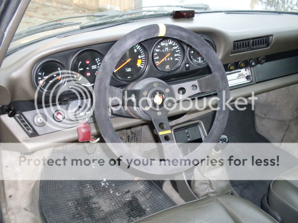

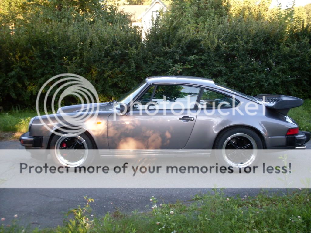

The car drives nice and is quite fast up to 255 km/h. I goes faster but i dont know how much.
The only thing i am not pleased with is that i run a 915 transmission so i cant use firsth and second gear properly because i am afraid to brake the transmission which i have done once already
Here is a picture of the car
Running 225/45/17 front tires and 255/40/17 rear tires on 7,5x17 front and 9x17 rear rims.
It is Fuchs replica wheels as you can see. They have almost the same weight as 16x9 original Fuchs and they work great
I have never liked the original steering wheels for the old 911 so i use a suede Momo GT2 wheeel. I also like to use rubber floor mats
I have been thinking of replacing the clock with a boost gauge

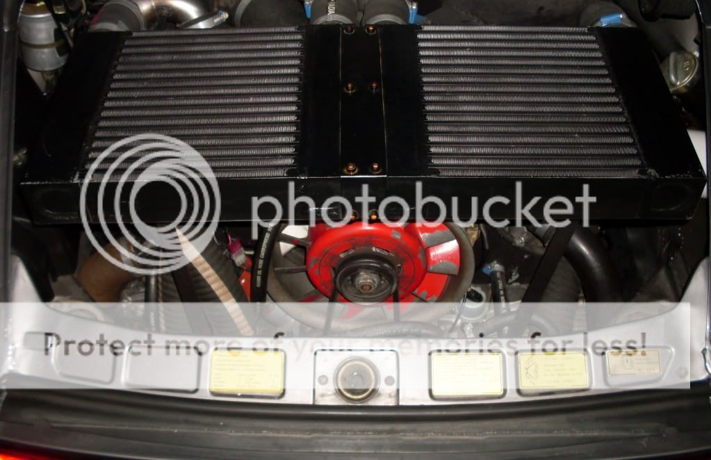

The car works good as is. I think i will change the intercooler, hoses and hose clamps but that is most because of looks
Just changing to hose clamps like the one on the picture below looks better. I usually change all of the hose clamps with plastic on them and also every wire connection that uses ply on connectors which i solder on
This is the one in my car at the moment and i am not pleased with how it looks. The core is thin too
I want a intercooler that looks something like this
or this

Nice looking car. Very stealth

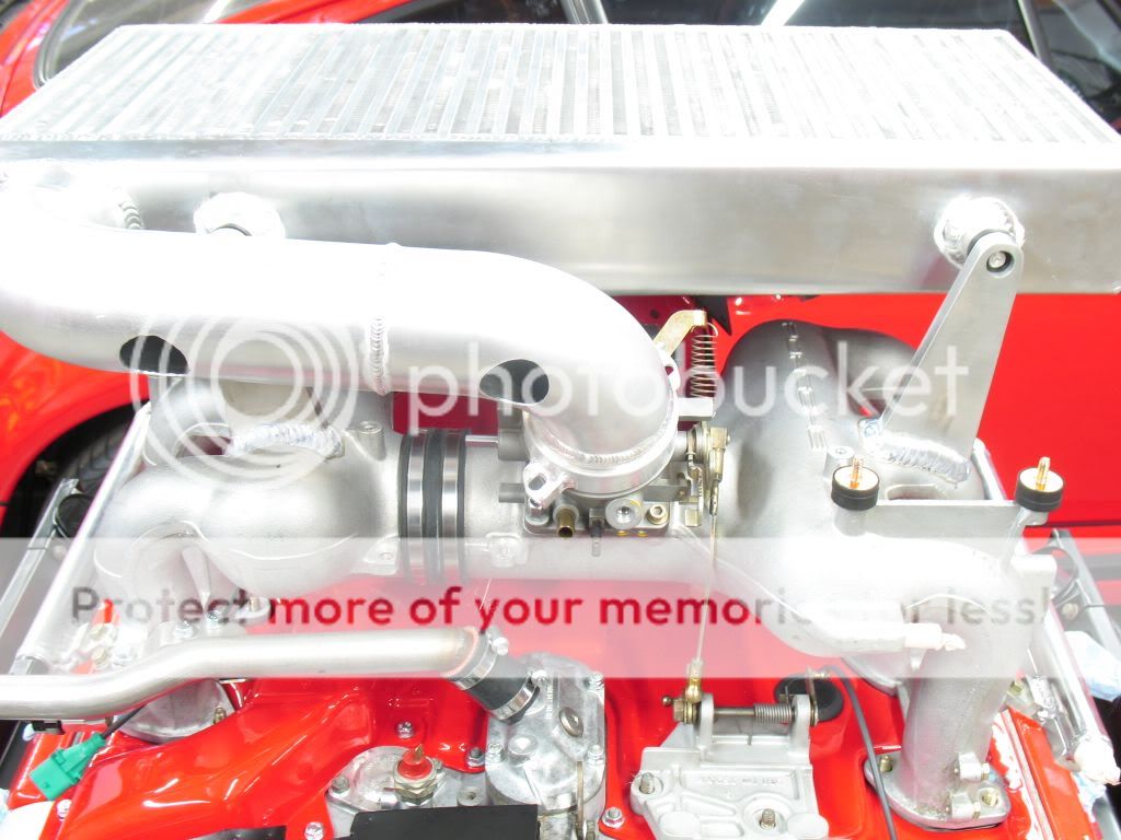

Twin turbo intercooler in my 930.
Dang dude... looks like you been using your cooling fan to grind up bodies or something. That's some scary $h!t!!!

Really nice set up And your turbos is bigger than the ones on my car
Is that two 12" x 10" x 4" intercoolers welded together? Have you bought the intercooler from Albert Liang at goingsuperfast?
It looks really nice and that is the look i really like
Are you pleased with the intercooler?

Those are some BIG snails At a guess, I'd say they are either GT30R's or GT35R's ?! Am I correct? How quick do they spool race911turbo? I would have gone for some nice GT28RS turbo's for that configuration for quicker spool and decent top end power (~700 crank HP)

Those look like gt35's with Tial SS hot housings, to big for the displacement.
Race911turbo=Albert Liang
