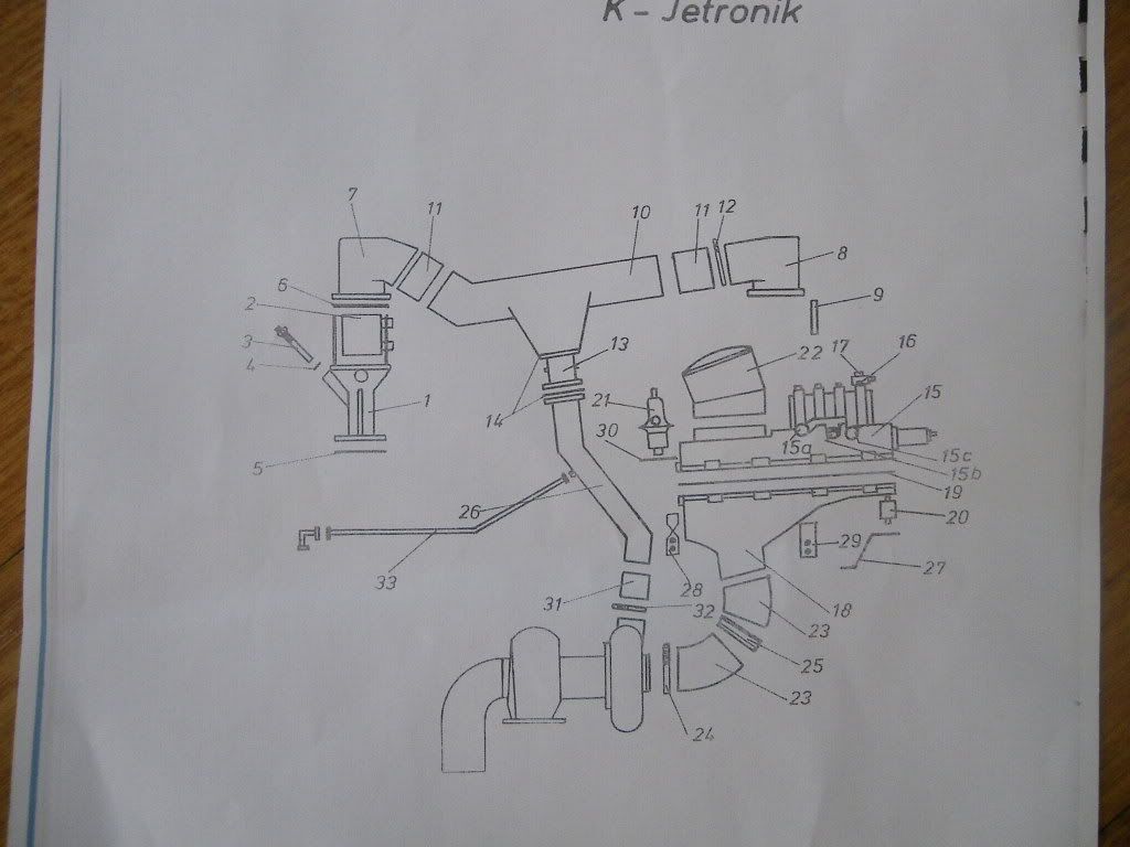

vas930 03-21-2012 08:45 PM
Sorry this has taken so long, Cole.
The dang thing just wont let me post the file.
So I have taken some pics.
This is out of a gen factory 934 man.
http://i1188.photobucket.com/albums/...ilips/0012.jpg
http://i1188.photobucket.com/albums/...ilips/0022.jpg
http://i1188.photobucket.com/albums/...ilips/0032.jpg
http://i1188.photobucket.com/albums/...ilips/0042.jpg
Not sure if this is of any help.
Cole, I can get you a copy of the factory info if you want.
A good friend of mine has a set.
He wont let them out of his hands, but I can get a photo copy for you.
Let me know if you want them. :)
