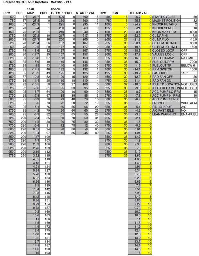

Kenik,
Since your at 8.3 CR, I think it is a good starting point for twin plug. At 8.3:1 your effective CR is going to be higher when you get into boost. You can add 3 or 4* in the 65KPA and below rows for your cruise areas as you will want lean mixtures (at least 14.7:1) here for MPG. You can safely add 2* to your 195KPA row. I run a little more advance than you, but I am only 7:1 CR at best after mods when I rebuilt my 3.0 liter.

Kenik,
There is an asterisk* at the bottom that says initial advance 8 deg. Are these numbers actual +8?
if so, then not so conservative for Twin plug.

Originally Posted by jpnovak View Post
Kenik,
Good question - I pulled this out of the text/print file. I'll look at the tune file (other laptop) later to confirm. If so - good catch, Jamie. That said, the cited tune is from a single plug motor on pump premium, so we'll see what it really means

Posts: 7,665
Did a little bit of tweaking-by-phone with Richard as well on the timing. He felt the higher Kpa values were far too low and the car would run like crap. So we bumped everything up to 20, per below. Plan is turn her over tomorrow and start tuning.

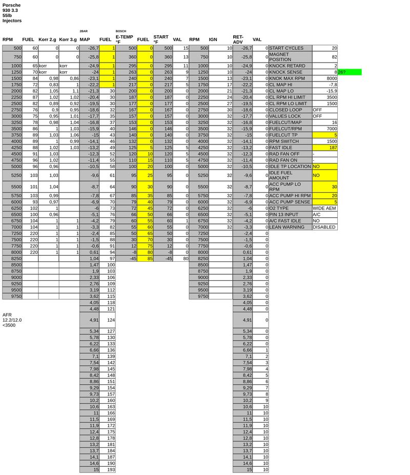

Does anyone have any EFI maps for an 86 930 efi project?
Old 04-23-2023, 03:09 PM
proffighter's Avatar
Join Date: Aug 2007
Location: Switzerland
Posts: 2,383
not 86 but 81 (does not matter I guess). about 95% tuned, so on your own risk:
from another pelican fellow or me, can't tell anymore:
Roland
930 Turbo '81 Too many modifications to list
Old 04-24-2023, 12:24 AM
Join Date: Aug 2007
Posts: 2,383
hmm png not shown. so here it is:
Roland
