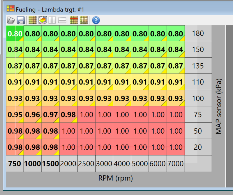

My 3.0CIS Turbo Map
Here is my initial ignition map.
Stock 3.0CIS engine but with 9.5:1 compression. Stock SC Cams. Single plug.
Stock headers with J Pipe. Turbo is a Pulsar 3076 0.63a/r. EFI using 3.2 manifolds and Ecumaster Emu Black.
Wastegate is Tial F46P with 0.5 Bar Spring
Engine starts and runs well. Drives OK but I have been very gentle and not seeing boost often.
Would appreciate some pointers on where to go from here (yes, a dyno and pro tune is on the cards)

@mikedesilva thanks for sharing your map. One q - I see you’ve got the timing increasing right up to 7250. Some level off the advance or even taper it a bit. Curious to know your thinking in doing it that way.

Was purely an entry level map given to me to get me running on the test stand and also for the car to be drivable before going to a tuner. There doesn't seem to be many people who have efi on their cars that are reading this sadly

Any other takers willing to share ignition tables?
In particular, Im trying to understand where to advance in order to increase spool up earlier in the rpm range...
3.0SC engine with 3.1 kit (9.7 Max Moritz pistons, SC cam, 3.2 manifolds, aftermarket ecu,COP, std heatexchangers with J pipe, Pulsar 3076R,no intercooler yet!

Retarding the ignition on tip in should speed up spool, unfortunately I have not gotten to the tuning portion of my engine, so I have no map to share.

Here is mine but why do you think my advance number is higher than specified? I do have mat and oil temp adjustment but at the temp at the time it should have been out of the equation. Thoughts?

Here is my Megasquirt Pro Ignition Map.
Idles well, 1st is very short, pulls strong through 2nd, 3rd and 4th. Would like to play with retarding timing to spool earlier. Thoughts on where to adjust my map. Engine is Twin plugged.

Interesting. Who wants to show the afr table as well?
Turbo powa!
1977 911s. it's cool
Old 10-22-2024, 04:54 PM
Join Date: Jul 2013
Location: Brisbane, Australia.
Posts: 2,578
This is me..
9.5 compression.
intercooler
maybe Im too conservative?
