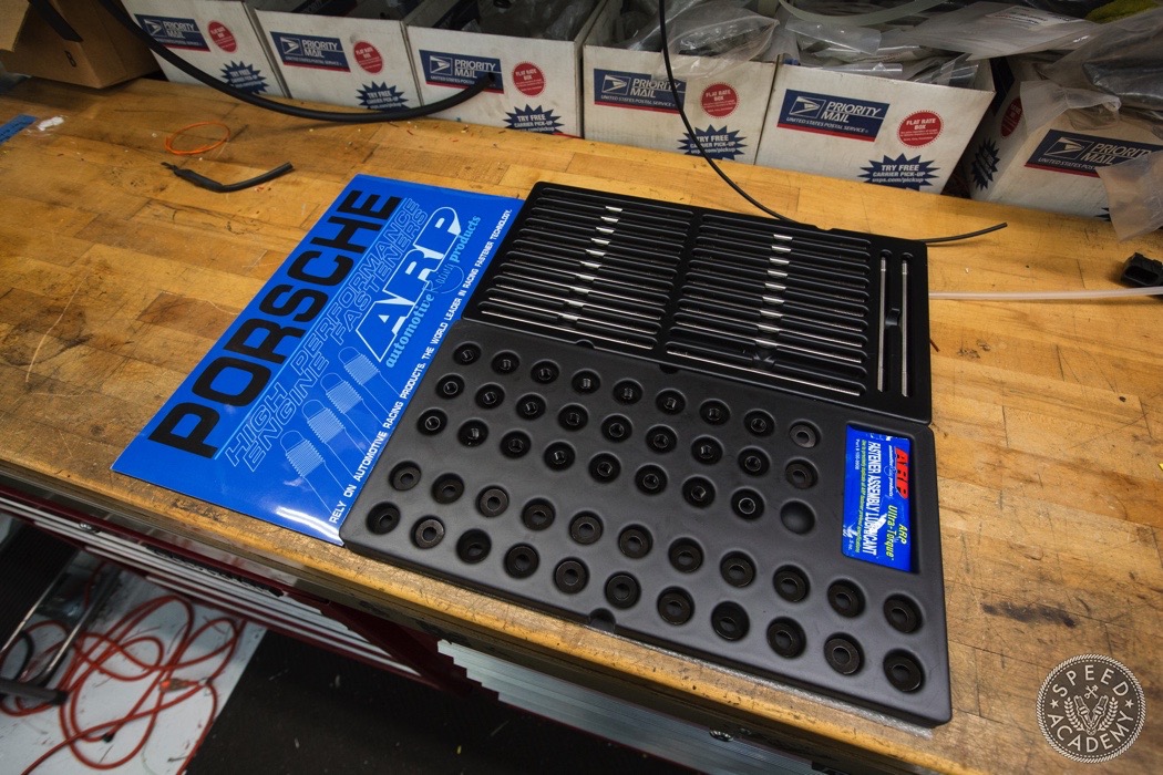

I almost choked when I saw the cost of the ARP rod bolts and head studs but when you factor in the volume they sell and the quality it made it much more justifiable. Plus I got a sweet work matt. :)

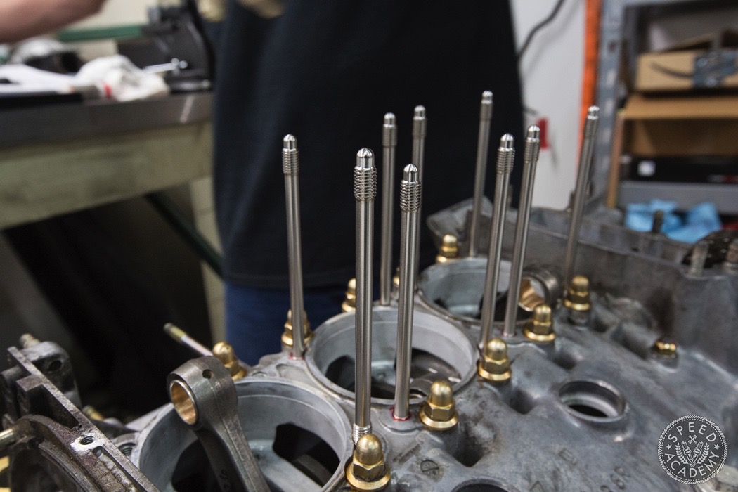

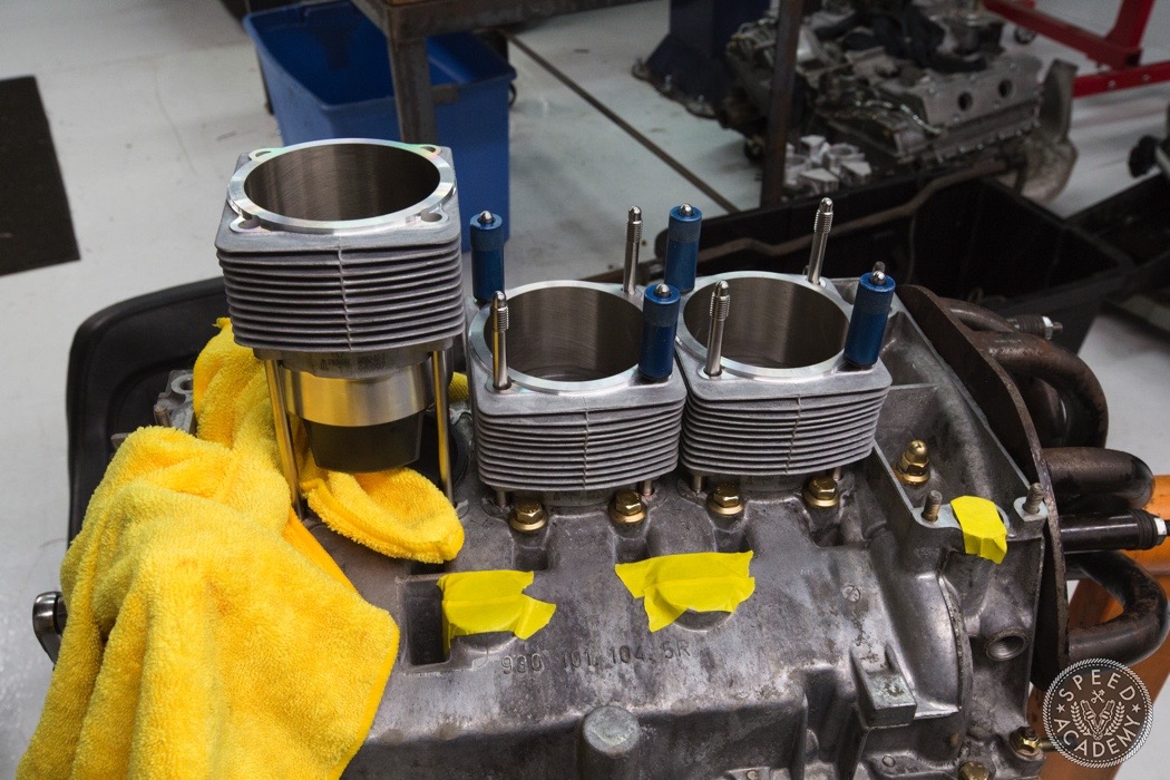

The cylinders and pistons going onto the rods proved to be a bit of a PITA since the snap rings Mahle provides aren't exactly easy to work with but in the end it all worked out.
http://speed.academy/wp-content/uplo...-turbo-022.jpg

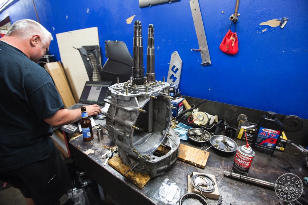

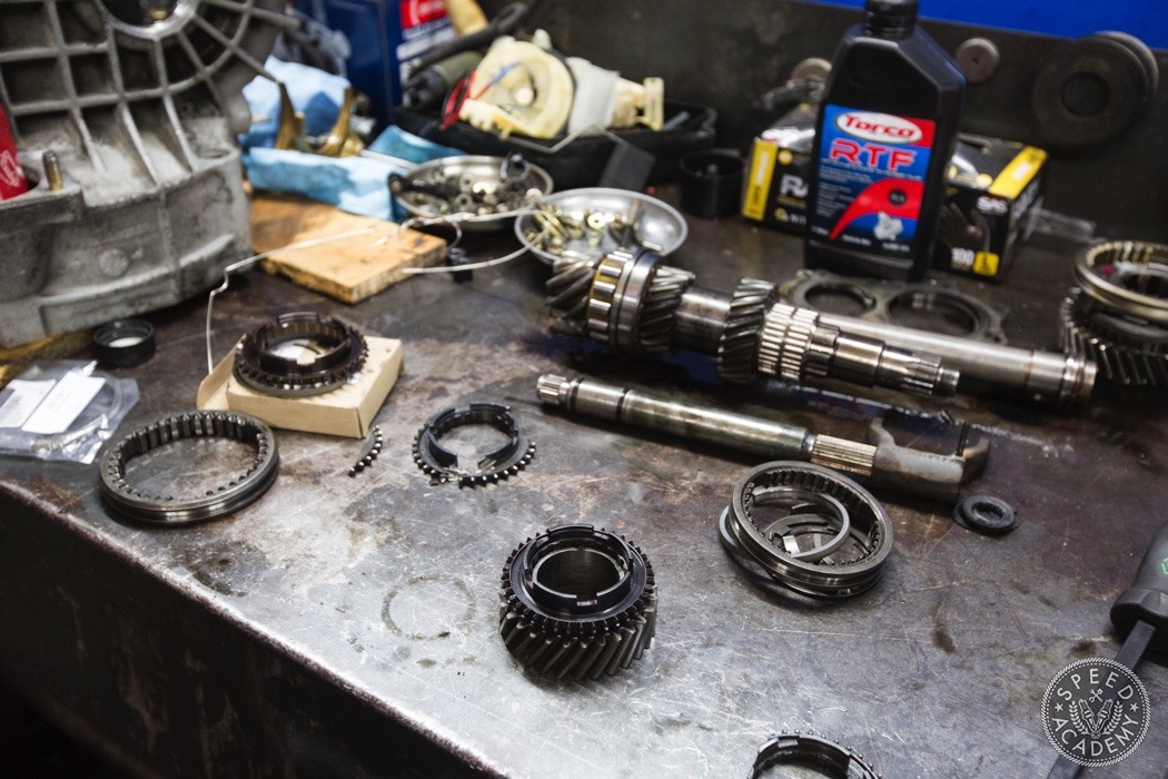

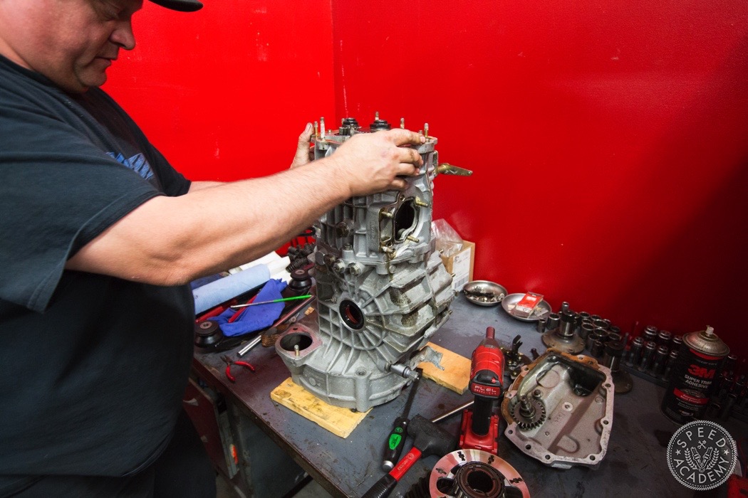

A good friend of mine, Tony at UMS Tuning used to rebuild 930 transmissions so he graciously offered to rebuild mine while I watched.
The 4 speed is actually not as complex as I expected and Tony had it torn apart in a few hours.
http://speed.academy/wp-content/uplo...-turbo-009.jpg
After some inspection, my 2nd and 3rd gear dog rings were worn out as well as the sliders. I also bought 4 new synchros since it just made sense to replace them all while everything is apart.
If you look closely you can see one of the dog rings cut in pieces. It was a massive pain in the ass to remove it, requiring a cutting disk and plenty of cursing and swearing. Tony spent over an hour removing both gears!
http://speed.academy/wp-content/uplo...-turbo-023.jpg
I'll have a full video documenting the process done in a few weeks but in the meantime I'll post any other photos of the rebuild once we complete it.
http://speed.academy/wp-content/uplo...-turbo-024.jpg

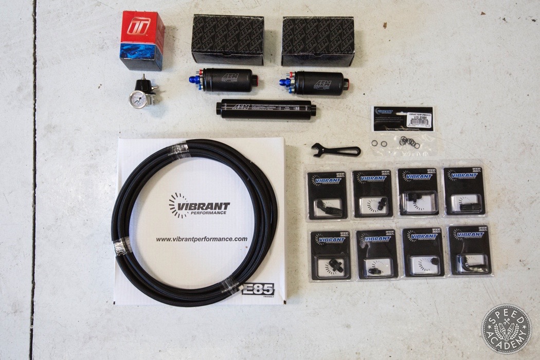

Here's what I'm working with for my fuel system upgrade.
Ive got a set of AEM 380LPH inline pumps which are Bosch 044 style but don't cost nearly as much.
I'm using all Vibrant hose and fittings in black. I've been using a lot of their fittings and hoses lately since they are local manufacturer (Toronto) and really love the quality of their stuff. Plus the price point isn't bad either.
Last is the Fuel Pressure Regulator from Turbosmart. I've used this thing on a few of my builds and love how compact it is.
For reference, Im using all -6AN lines as it's plenty adequate for my EFI fueling needs.
http://speed.academy/wp-content/uplo...-turbo-010.jpg

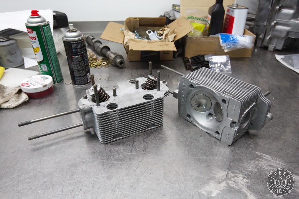

Chris sent my heads out to have all new hardware installed. We got larger valves and better valve springs and retainers.
http://speed.academy/wp-content/uplo...-turbo-025.jpg

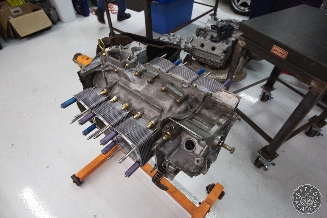

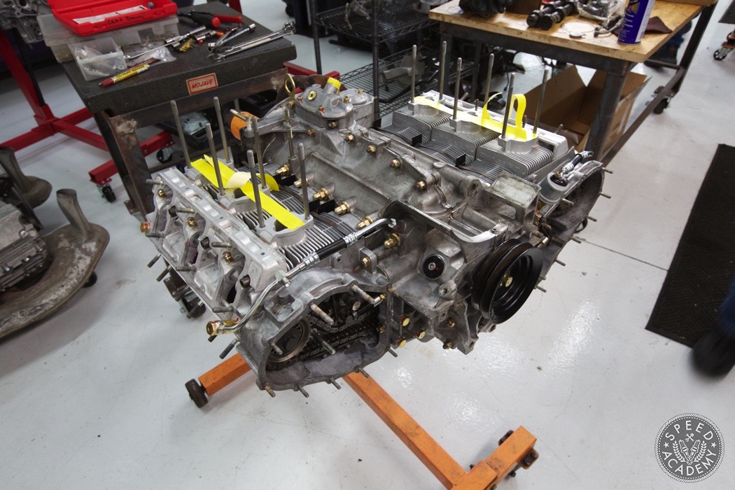

Here's the engine where we last left off. The Mahle 3.4L pistons and cylinders are on and we're ready for the heads.
http://speed.academy/wp-content/uplo...-turbo-026.jpg

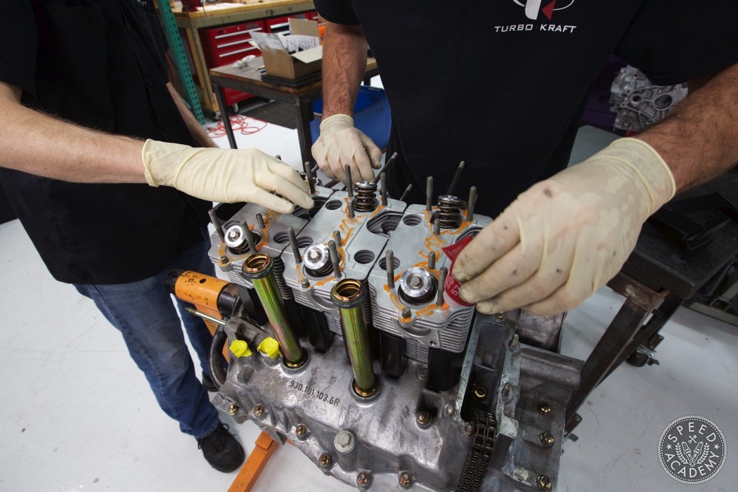

Of course, more loctite 574 was used, Chris and Mike use this stuff every where there's a chance of oil leaking which I appreciate so much. I definitely don't want to see any dripping after this rebuild.
http://speed.academy/wp-content/uplo...-turbo-027.jpg

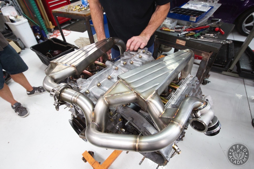

I bought these headers off my buddy who didn't end up using them on his 930. Apparently, they are Kenny McNeil headers?
http://speed.academy/wp-content/uplo...-turbo-029.jpg

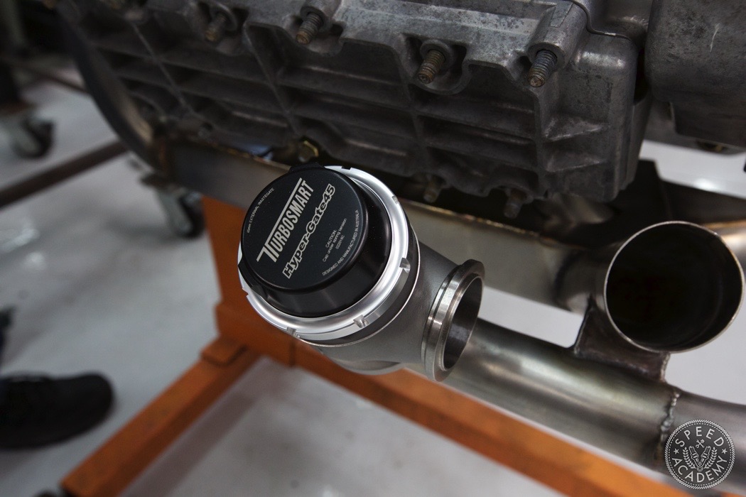

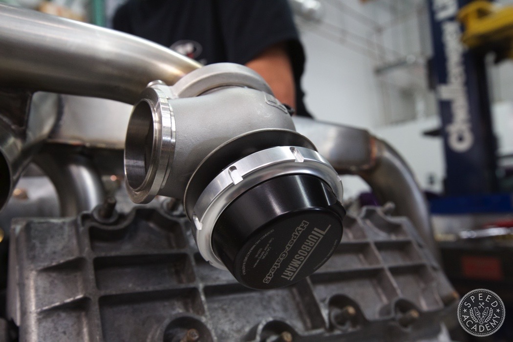

I really didn't need to change out my Tial 46mm wastegate but figured what the heck, the Turbosmart one is never, more compact so why not give it a try. Plus I really like the v-band setup on it.
http://speed.academy/wp-content/uplo...-turbo-030.jpg
http://speed.academy/wp-content/uplo...-turbo-032.jpg

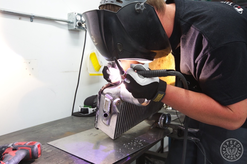

John, the fabricator over at TurboKraft has been modifying all my existing parts to work with my new setup including my Andial Intercooler which needed some holes plugged and new brackets made up.
http://speed.academy/wp-content/uplo...-turbo-031.jpg

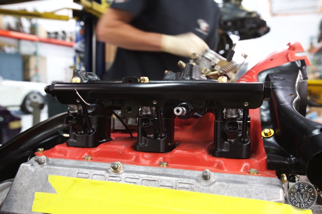

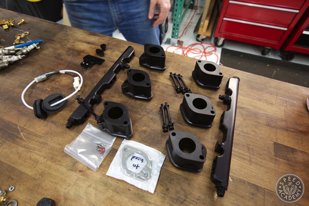

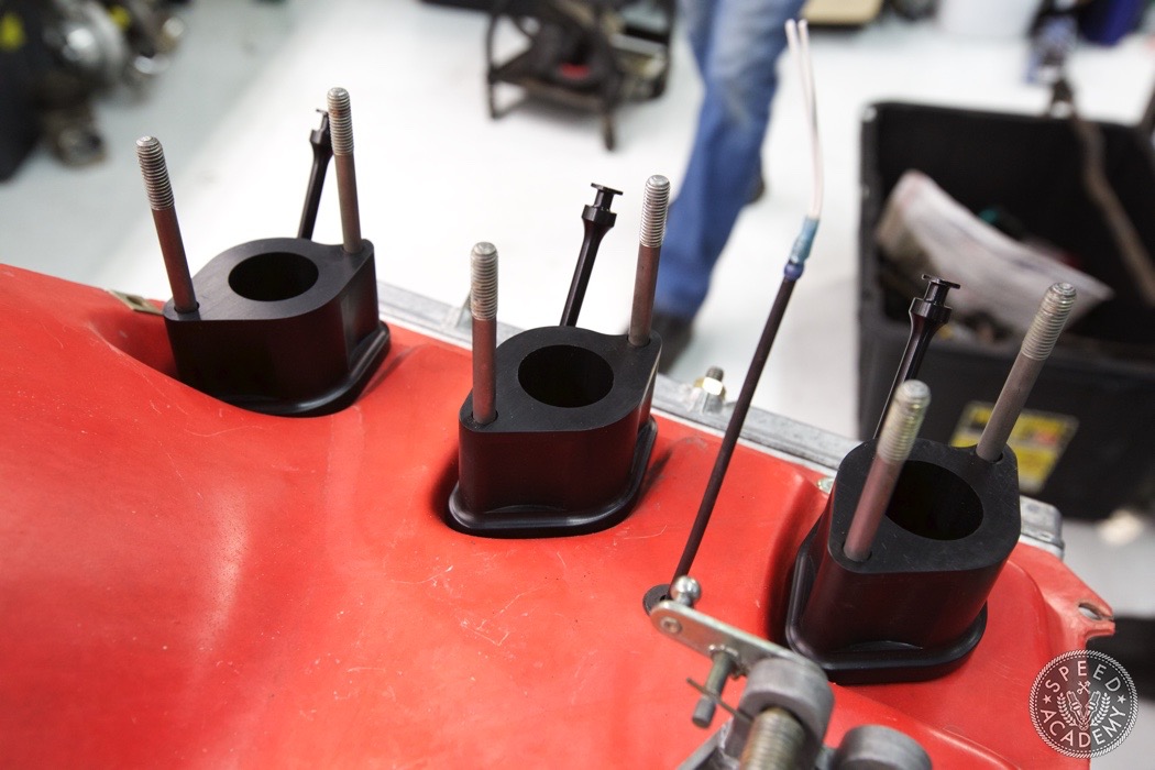

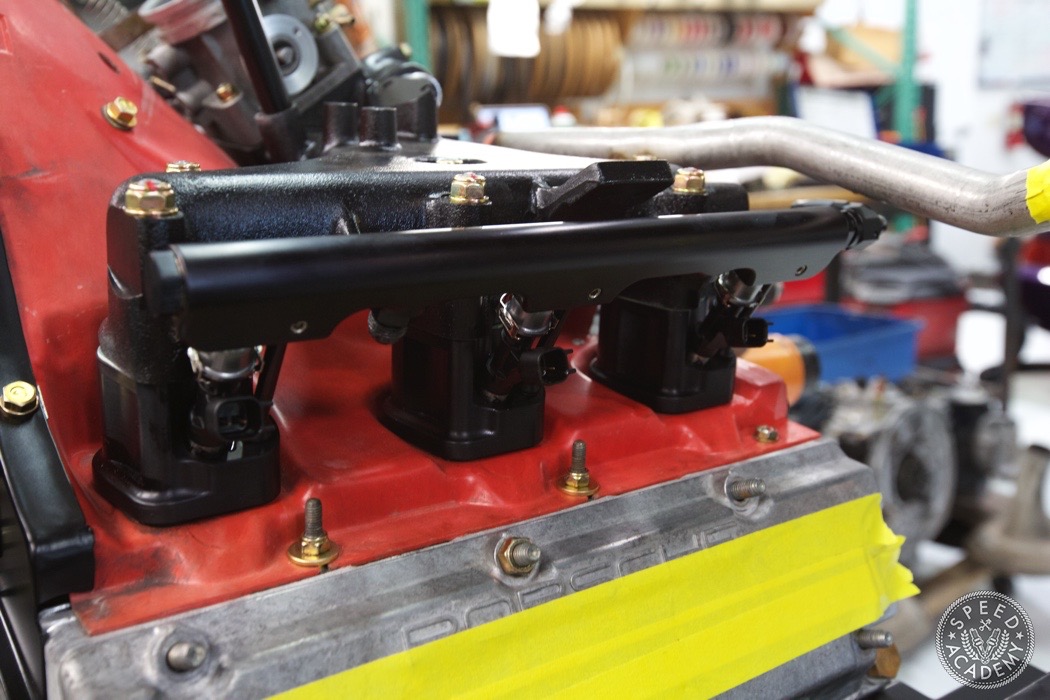

Here's TurboKraft's EFI conversion fuel rails and billet injector blocks. This kit is absolutely stunning in person. After having Chris explain the features to me I can see that he's put in a lot of R&D to ensure these are durable and work flawlessly.
http://speed.academy/wp-content/uplo...-turbo-033.jpg
http://speed.academy/wp-content/uplo...-turbo-034.jpg

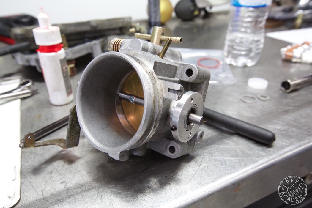

Another mod that needs to be done in order to run EFI is the throttle body needs a TPS. No problem, Chris has the solution for that with a new shaft and additional fitting on the side of the TB.
http://speed.academy/wp-content/uplo...-turbo-035.jpg
The TurboKraft fuel lines and injector blocks fit up so well along side my manifold that I painted black. I'm running ID1000 injectors in case you're wondering.
http://speed.academy/wp-content/uplo...-turbo-037.jpg
http://speed.academy/wp-content/uplo...-turbo-039.jpg
Here's just a cool shot from below. :)
http://speed.academy/wp-content/uplo...-turbo-038.jpg

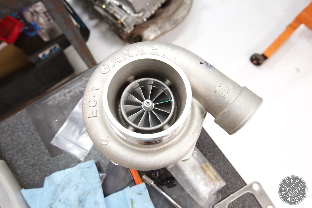

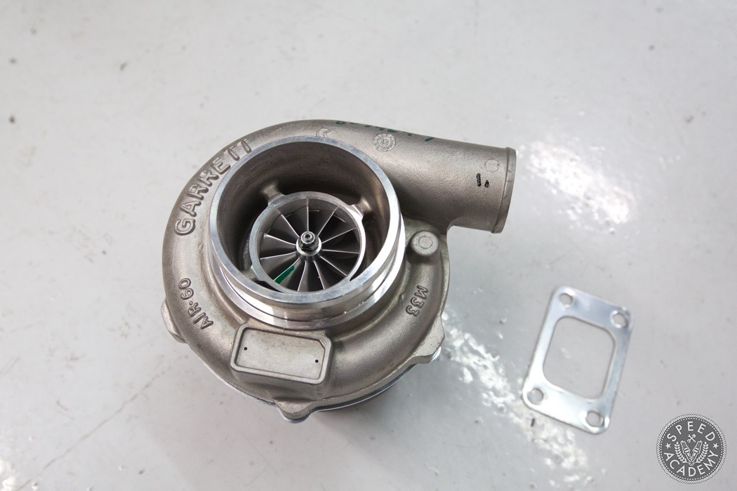

I'm going to be running a Garrett GTX 3582R as my turbo but we're installed a smaller GRTX 3076R turbo first to see how it does. Odds are the turbo is too small but this back to back test will provide real world results as to why or why not.

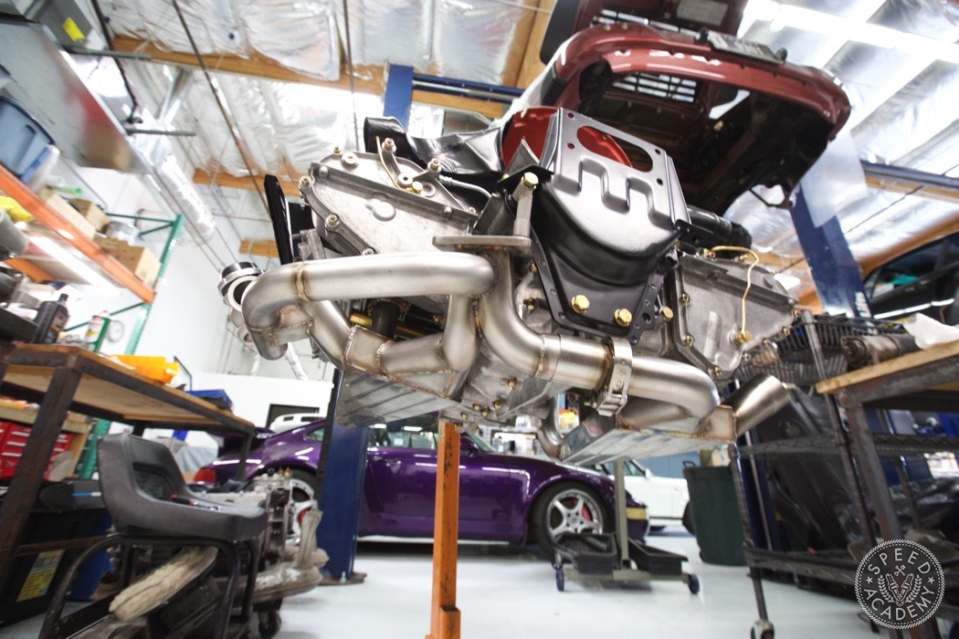

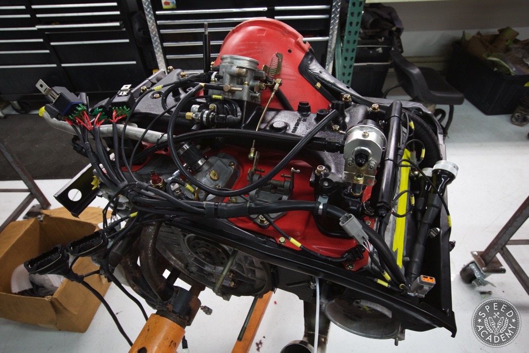

Mike got as far as installing the wiring harness, FPR, TB and fuel lines before we ended today. I'm so excited to see this motor finally coming together. It's just a shame that we've been waiting for parts for many days now because this build would be further along but that's the nature of the business I'm finding.
I've never been patient with shops but now I get why there are so many delays. They can't control when parts arrive and when they're on back order. Still though, I'm happy we've come as far as we have in the time frame. I need to get home soon but will be hanging out until we're done here!
http://speed.academy/wp-content/uplo...-turbo-043.jpg
