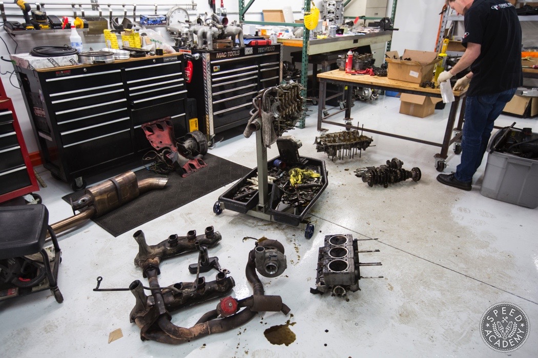

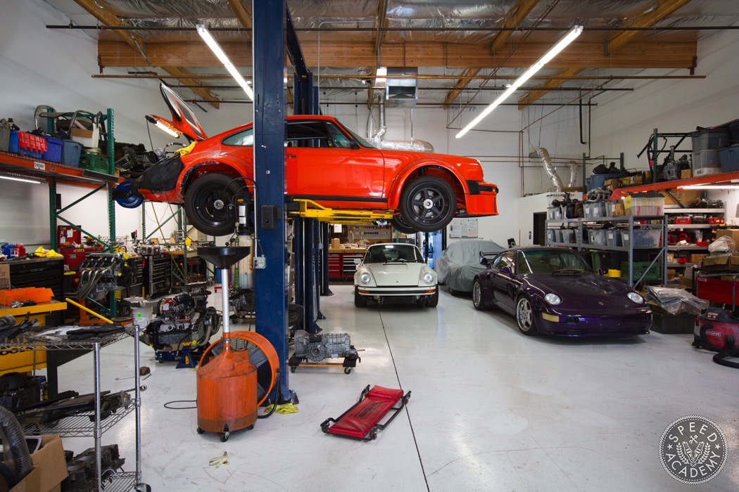

The shop has so many cool and extremely rare cars that I couldn't stop drooling over them when I arrived.
This 964 twin turbo engine has got all the best upgrades including ITB's, 997 GT3 crank and it's going into a RWB car that is at the shop. The want is high!
I've longed for a Ruf 930 so seeing one in person and watching Chris and Mike tear down the engine has been spectacular.

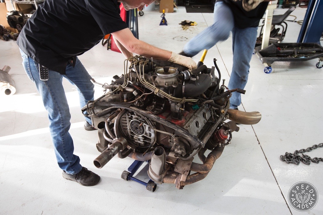

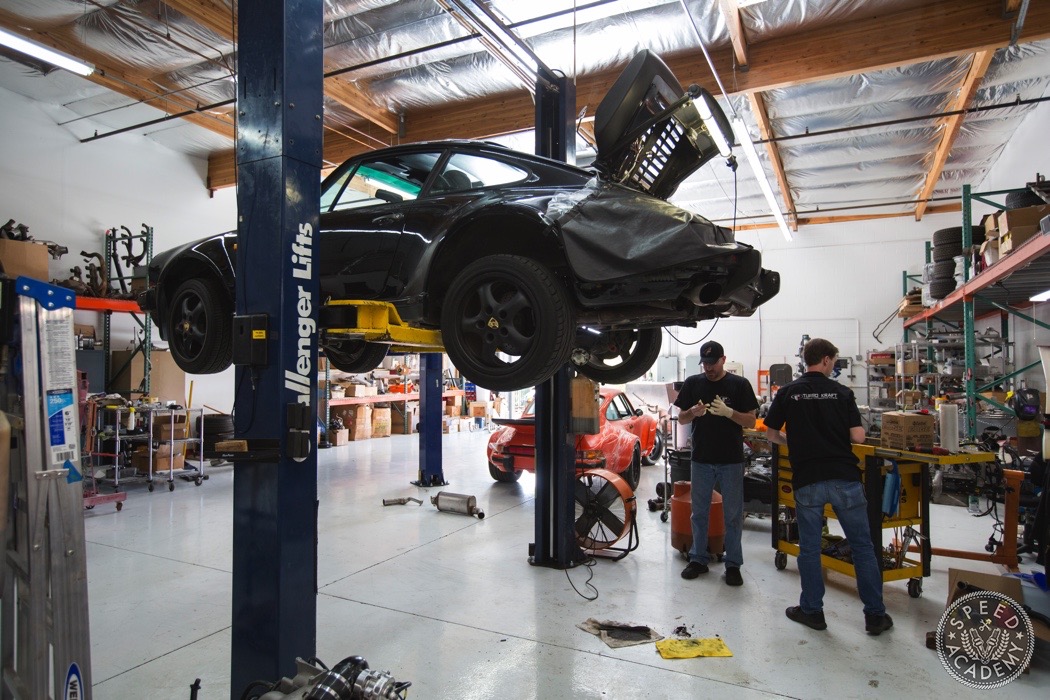

This here is my turd, getting ready to have it's engine and trans extracted. I've contemplated an EFI swap for quite some time after giving up on CIS and trying to tune it. I know some will disagree but I found CIS to be extremely archaic as a fuel delivery source for a modified engine and that's why I decided to go EFI as I want to have the modern perks of reliability, big power production, and ease of tuning that all come with EFI.
It's inspiring watching Chris and Mike pull a 930 engine and trans. They've got the process down to a T and are so efficient at it.

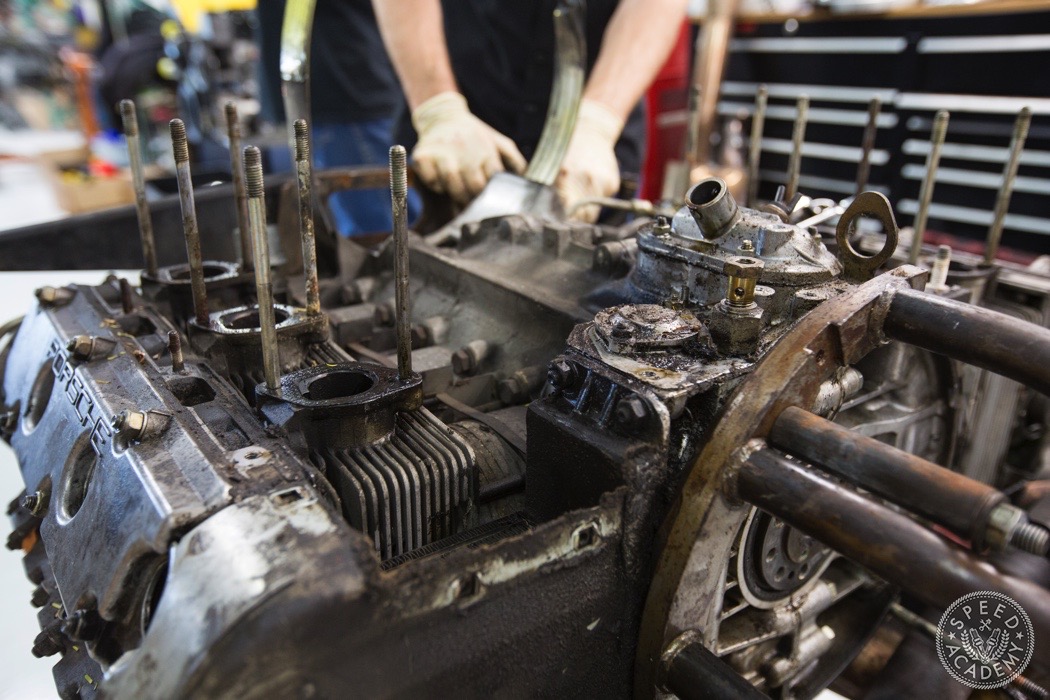

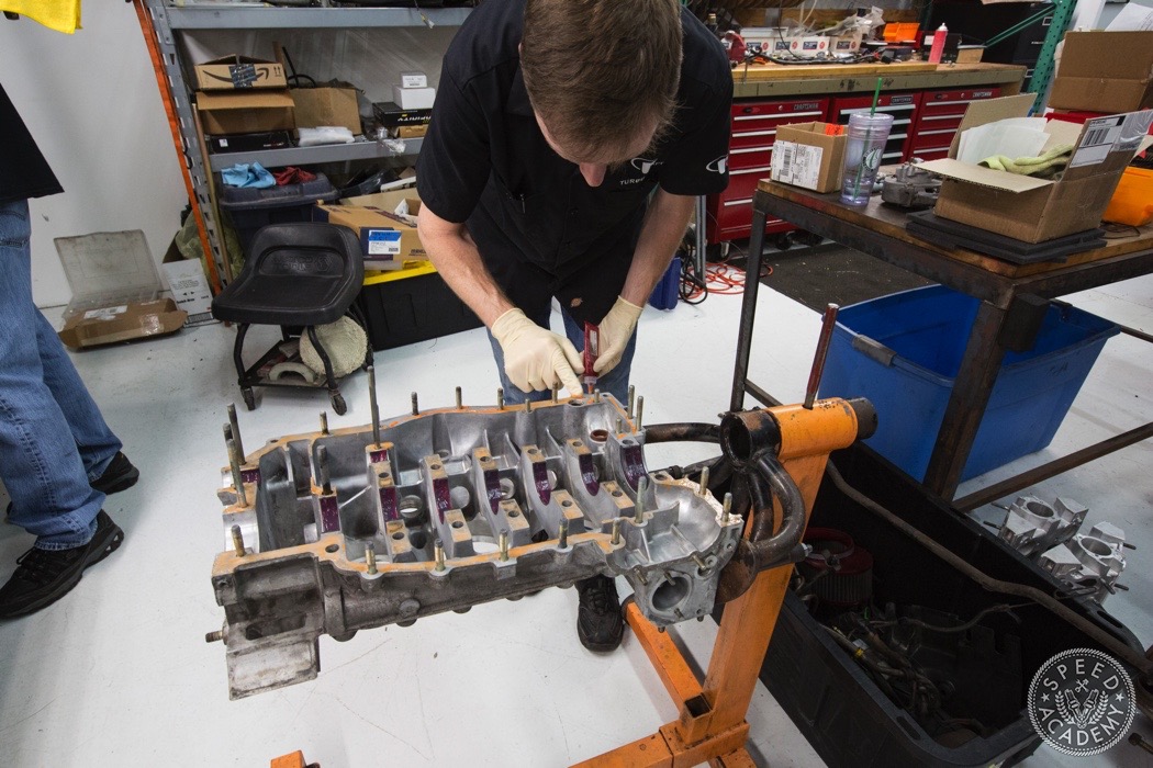

Same goes for the engine teardown. I've never worked or seen an air-cooled Porsche engine torn down before so having a front row seat for this was incredibly educating and eye opening.
You could say my engine had a few leaks.
And this is where we ended the day. My engine is completely torn down and now we send parts off to the machine shop and assembly will start soon!

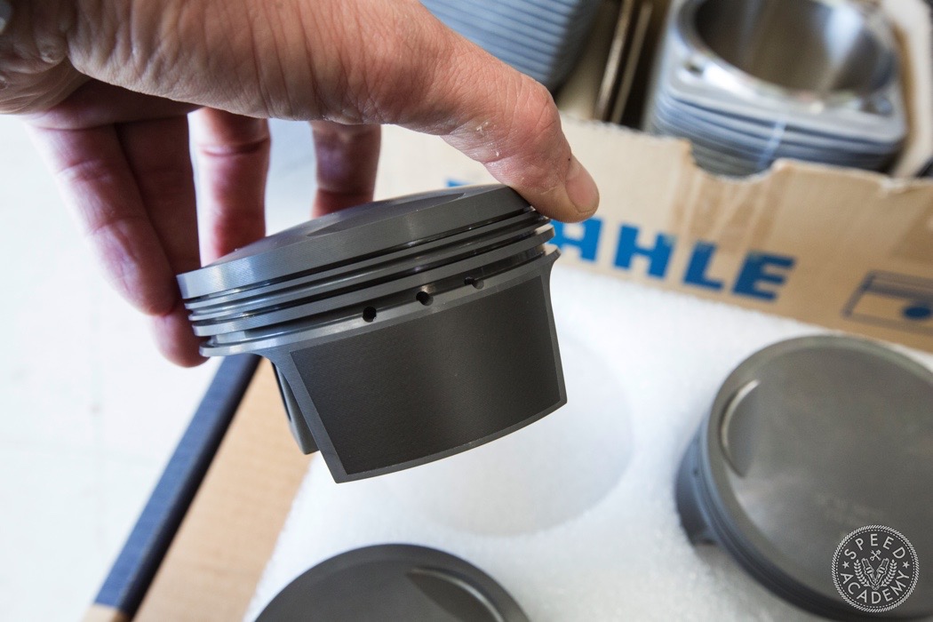

Jeff- I'm not really expecting anything other than reliability. From what I've seen though, I can expect anywhere from 400whp low boost to 500+whp at moderate levels (18-20psi)
Progress has been fast but the machine shop has slowed our pace a bit, we're still waiting for heads which means the rest of the engine can't come together but I know have a short block!

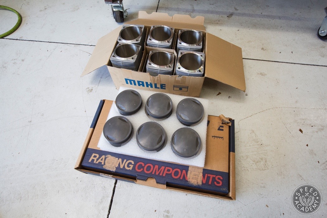

Let me back it up a bit though. I went with the Mahle 3.4L Piston and Cylinder Power Pak because I wanted OE reliability but with a high performance application. This way I get the modern technology of pistons with coatings and modern rings and everything is guaranteed to fit like the factory stuff.

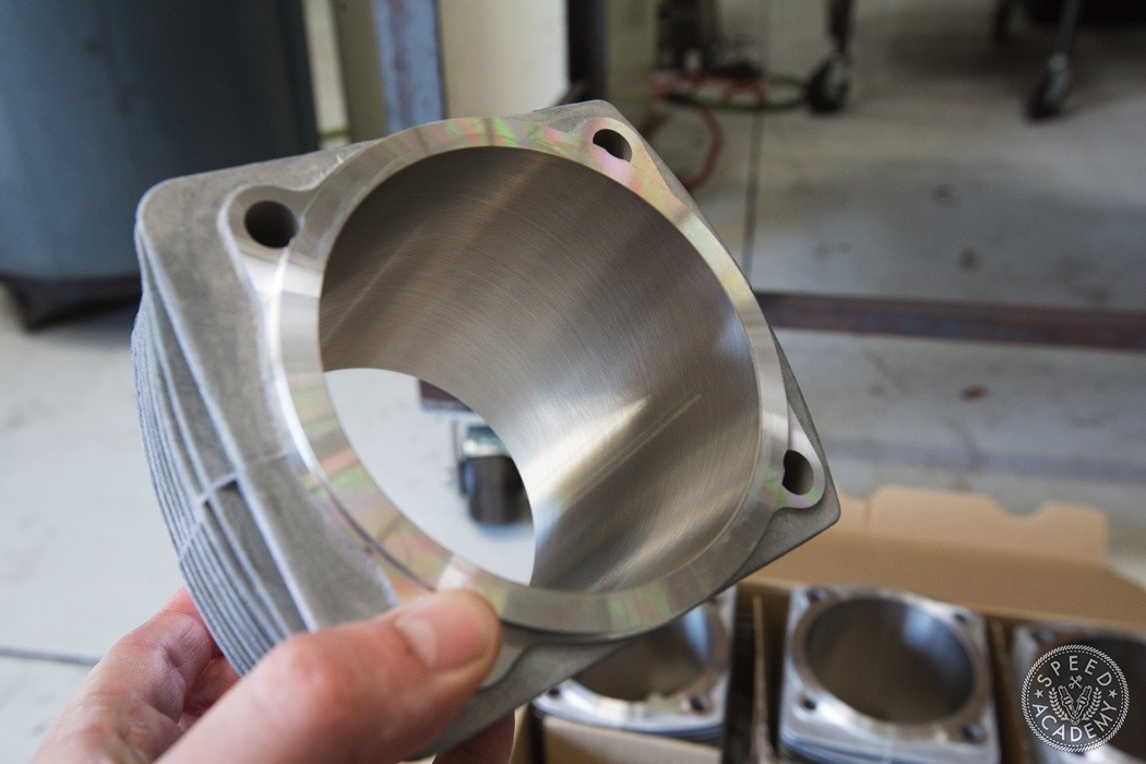

Just check out how pretty the cross hatching is on these cylinders!

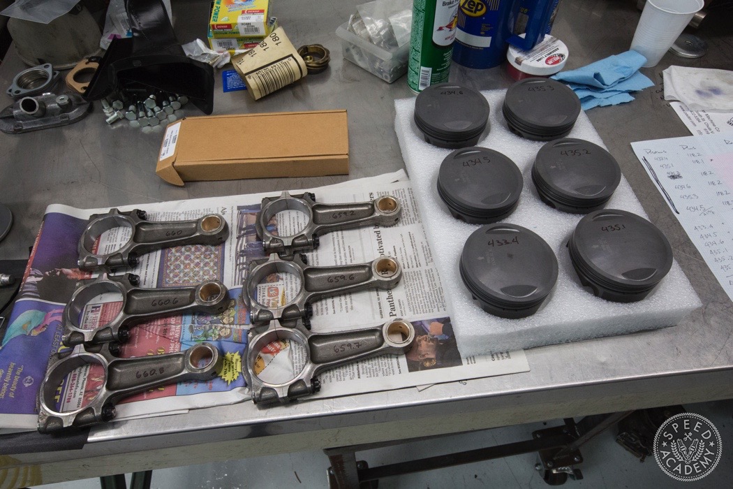

Before Chris and Mike assembled my rotating assembly, they measured everything and determined what rods go with what pistons to ensure the best possible balance.
I'd never even thought of doing this and was reminded again why I left it to the professionals.

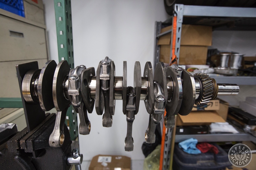

And here's my freshly cleaned and polished crank with my stock rods installed. I did upgrade the rod bolts as Chris said they are the one weak point in an otherwise very robust rod.

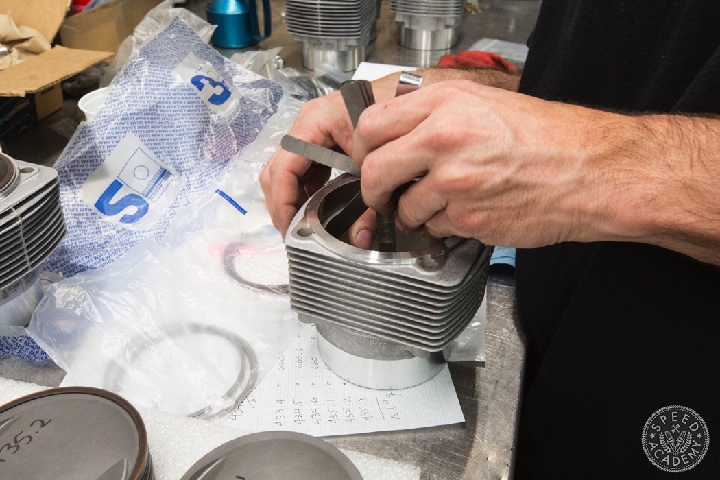

Mike made sure all the piston ring clearances were correct before assembling them with the cylinders. Again, another attention to detail that I was impressed with because technically they should all spec out out of the box.
