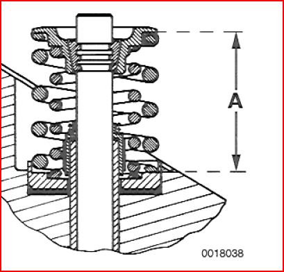

Something I think I should add here. Valve springs should never be installed on their installed height, rather on their measured installed pressure.
Springs sag over time, along with other factors and the aim here is to put the same amount of pressure on each valve to seat when closed and the same force over the nose of the cam on opening.
Typically, the springs are "over sprung" for most applications. I think this is done for many reasons, the main being nothing is ever measured and "its safe" and wont be a problem. True enough, but your engine has to turn against this added un needed force and when you make 180- 250 BHP, you are giving away free HP.

Just to make sure I am clear on the data presented, is the 1.358" (34.5mm) dimension is as shown here?:

Yes.

Ok got a set of stock springs.
Measured a few of the retainers and seats and found some variance, so used one set for checking the springs.
Based on 5 springs checked so far, I get results similar to the info posted by Neil, using my at-home tester:
Then I took everything to a local engine shop and borrowed their little Intercomp tester and checked each spring/retainer/locator assembly, determining the installed height to achieve both 60 and 65 pounds. Based on the 65 pound reading, I added 11.5mm to get the valve open force.
Interestingly, there is 0.5mm of variation in the height to achieve either of the loads - I guess that is why measuring is a good idea, although based on the spring rate 0.5mm amounts to only about 6 pounds.
The force increase as 11.5mm lift is consistent at 140 pounds.
So all is good EXCEPT that the installation heights using 65# result in a spring height(for comparison to the Porsche spec) of 35mm; 60# is 0.4mm more.
If I shorten the installed height to 34.5mm, the force will be 72#.
Given this is a more or less stock engine, probably the spec height is OK but there has been discussion about these forces being on the high side, so my dilemma is what height ( or, really, what installed force) to use.
On a side note, the "racing" springs that were installed be a previous owner are, as in my earlier emails, very strange and I cannot fathom why they were ever made, much less purchased and installed. They have a 15% lower spring rate than stock, but are much longer, so that even with a minimal thickness locator the installed force is 125# or so. The force with the valve open is 45# higher than stock, but since the spring rate is lower, the increase in force as the valve opens is 125#, 15# lower than stock, so the higher open force is achievedby increasing the installation force by 60 or 70 pounds. Seems goofy.
Especially since the increased forces are likely, upon reflection, the cause of the IM gear failure.
And especially because it has stock cams.
Anyway, any input regarding the installation force will be appreciated.

Yeah - I have 2.5mm +/- before coil binding on the intakes.
How many shims are normal? I am shimming 2 to 2.75 mm, so quite a lot of shims.
The valve length (projection above the head) is all within spec.
I've decided to set the installed height so that the force at 11.5mm lift is targeted at 205#, and let the force when the valve is closed to float. This approach results in the closed force to be 59 to 65# and the installed spring length 34.5 to 35.3mm.
I noticed a small but repeatable difference in the spring rates, ranging from 313 to 320 lb/in; this approach compensates by setting the fully open force.

With the stock springs I have, If I set them to 34.5mm, the seat force is 61 to 71 and the over the nose force is 205 to 215.
Working with 0.25MM shims, I can get the over the nose force to be 205 to 208, with the seat force 61 to 65.
Or I can add force in 3# increments using 0.25mm shims.
Question is whether 205 over the nose is enough with stock cams and valves, and 6800 rpm redline. Seems to me that it should be OK as the forces are in the range that using the 34.5mm spec would achieve.

Wrapup
Spring installation is finished, heads given a light spray of WD40 and bagged til spring.
Thanks for all the input - it has been an instructive project.
At the end, I shimmed the valves targeting a fully open over-the-nose force of 205# at 11.5mm lift.
The results are the force ranges from 205 to 208. A 0.25mm shim increases the force by just over 3#, so this was as close as I could get.
The closed seating force ranges from 60 to 65. Essentially any differences among the spring assemblies is taken at the seating force.
Of course, the exhaust valves only open 10mm, so the forces on those are lower - 186 to 189 over the nose.
Interestingly, the above resulted in the spring height, specified at 34.5mm, being between 34.5 and 35.2. If the springs had been installed at 34.5, the forces would vary spring to spring by 8.5#, compared to the 3# I achieved by measuring each spring.
It seems to me that for a more or less stock engine, in particular with stock cams, the variances outlined above are not enough to compromise the performance.
No reason to not go through the exercise, though, other than it was a lot of work.
