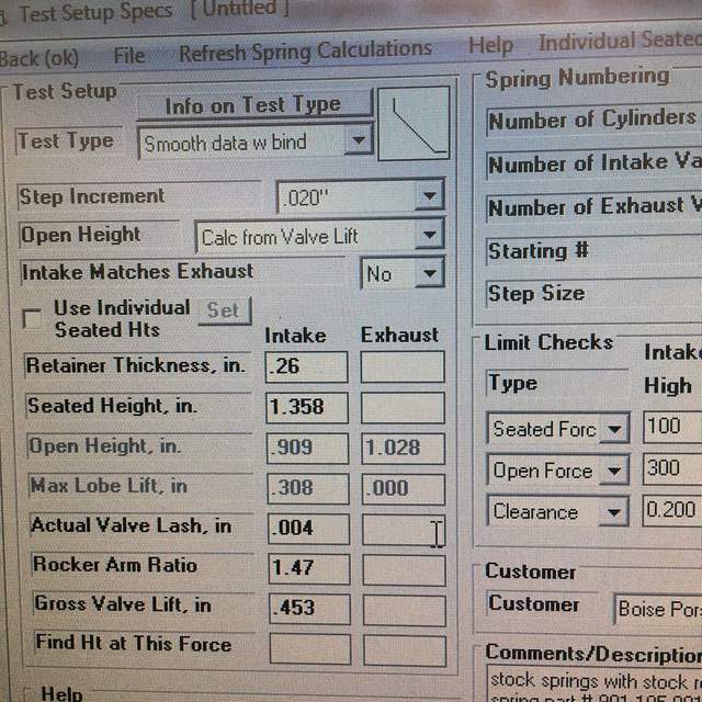

Old 12-03-2018, 05:04 PM
Join Date: May 2004
Posts: 889
Here you go.
Stock retainer and base with stock spring 901 105 901 51
Old 12-03-2018, 06:00 PM
Join Date: May 2004
Posts: 889
opps upside down,
Join Date: May 2004
Posts: 889
If someone can let me know how to flip the images, please do.
Old 12-03-2018, 06:20 PM
Under the radar
Trackrash's Avatar
Posts: 7,129
So, from your chart the installed seat pressure is 60 -65 lbs?
Gordon
'71 911 Coupe 3,0L outlawed

Old 12-03-2018, 06:51 PM
Join Date: Dec 2001
Location: Off grid in Eastern ONtario
Posts: 236
This is really helpful. Thanks for taking the time to gather the info.
New springs retainers and seats arrive Friday and I'll compare to this info.
Bob D.
