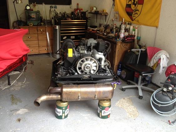

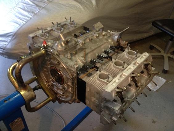

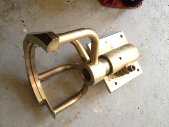

All of the 911 mechanics sleep at night just fine , you will too trust me..It is 2 studs with nuts on the end(some washers between)...here is my 911 official factory yoke with mounting bracket..
Ivan
when i do not need to put it the yoke i use Beer mini- kegs perfect height to work on the oil leaks and so;-)

The half ring is the mechanics of why it's safe the studs/nuts are just the clamping force.
For a test I tried the heavier full dressed T4 engine on a POS el'cheapo bug T1 motor mount with just the tabs, not a full half ring. Bent the carp out of the tabs, flimsy 2 arms were starting to bend, it was literally hanging off the studs. I wasn't worried about the studs failing.
The stand is also important, be careful if you have the HF 1000lbs stand, the one with the single bottom bar, with a fully dressed engine they can be tippy. I don't trust them with a 996 engine, not they can't handle the load, but because they are tippy.

Yes. The stiff, chunky half ring is why it works.
Put the nuts on and torque to the factory spec for holding the engine to the transmission.
The large pull of the bolts, probably > 3000 pounds each (full torque on studs that big in diameter is a large! Load) draws it together.
The half ring spreads contact out to get wheelbase for the case to react out the bolt tension.
Porsche used the same rig to build the 12 and 16 cylinder flat engines in the 60-70s
