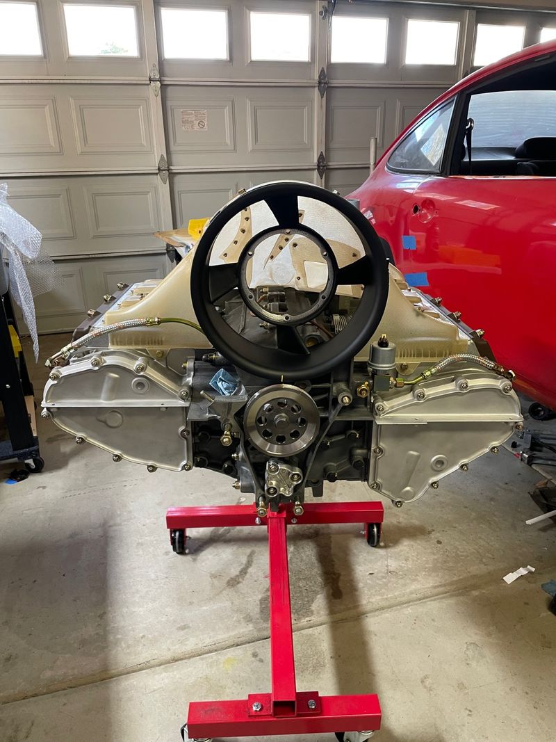

Back to where I was three months ago...
Rockers installed, valve lash set...
Lower gasket installed...
Lower valve cover installed, modified for twin plug by Henry at Supertec...
Upper gasket installed...
This is my engine. There are many like it, but this one is mine.
Valve covers installed. Cerakoted "Barrett Bronze" by Shaun at Tru6...
Custom cam housing oil lines by Brad at 911rennen.com...
Long block basically done!
Updates will be slow in coming for a while. Onward...
