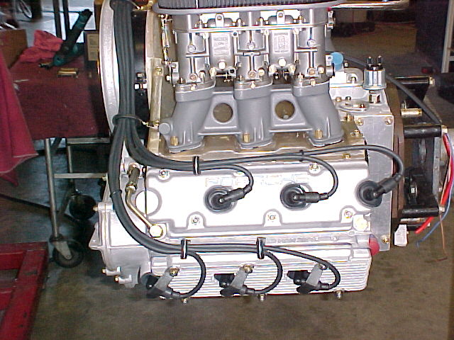

It seems to me it should be possible to produce twin HV spark output from a single primary / twin secondary winding coil such as MSD 8224. This coil appears to have suitable primary resistance at 0.35 ohms so as not to overload the CDI box driver output. Each secondary spark would go to the twin distributor HV input terminal and fire each pair of cylinder plugs.
However I am sure I am not the first to think of this, however all vintage 911 twin spark implementations seem to double up on CDI units and 2x single coils. I get there may be some redundancy benefits for racing, but that's not me / many of us. I understand ignition timing could be adjusted independently with 2x CDI boxes, however from my investigations, twin ignitions for performance are fired simultaneously. (And any engine forced to drop to single plug with only 26 deg. advance will be very sluggish)
I am thinking this can only be the vintage crowd staying traditional ... any other good reasons????

I see what you are thinking. These look a lot like the coil packs used in waste spark crank fire systems - three coils for six plugs (or double that if twin plug). In a waste spark system, the impedance (or resistance?) in the two cylinders, one open to the atmosphere, the other with a compressed air/fuel mixture, would seem to be different, but if this is significant perhaps the firing cylinder's mixture is lower impedance or resistance, so gets the most spark, or at least enough.
You are going to fire two "loaded chamber" plugs at the same time.
How did GM run these? Why did they use a coil with two plug wire outlets? I had a nice Chevy van in the 90s, but hardly opened the hood. Four packs for a V8? Looks like these were only used on V6s and 4 cylinder engines (3 or 2 packs). But this might confirm or deny your idea.

I'm not really sure what you're asking. If your question is "can a twin plug ignition function with a sign CD/" the answer is yes. We've been doing it for 20+ years.
From the MSD website.
Yes, you can do that. But, using a single MSD 6AL unit with two coils instead of two MSD 6AL units results in compromised performance. A single MSD 6AL is not up to the task. You will get less horsepower.....
I've been doing it for years. Are we leaving something on the table? not so you'd notice.
Dyno both ways with no discernible difference.

No race engine builder I know would use a single MSD with 2 coils....if they wanted the best performance anyway.
MSD for Twin Plug
Even MSD says you get half the energy at the plugs if you do this.

When I was designing my new race engine's CoP ignition system, I had the option of running two 3 channel ignitors or four 3 channel ignitors. With two 3 channel ignitors, I could have setup two coils on each ignitor channel.
The engine would run fine, but the CoP ignition system manufacturer told me that I would halve the energy at each spark plug and the engine would make less power.
My engine has four 3 channel ignitors....
Just because you can do something does not mean you should.......

The question was "will it work" and my answer was "it will work well and it's hard to tell the difference".
Is there always something that will make more horse power? sure but at what cost?
We run a single on street engines because lower compression engine don't need as much energy to trigger the required spark and if you have two CDs and lose one, you could very well damage the engine if you continue driving. When you have one DC that fails, the engine stops and there is no damage.

Yes, it does work. But it is not how it was intended to be done. Just because MSD documents the way to do it does not mean it is what should be done. You get only 50% of the energy at the plug you would using two MSD units.
I could say:
"If you have two coils and lose one, you could very well damage the engine if you continue driving."
I have seen coils fail MUCH more often than MSD boxes.

I have not measure the energy because there are specs on the web. The old MSD 6420 has less voltage and millijoules (480v and 115mj) than the MSD 6425 (530v and 135mJ) listed here:
https://www.holley.com/products/ignition/ignition_boxes/street/parts/6425
This text from MSD says that running the ignition with two coils in parallel results in about half the power per coil. See here:
MSD for Twin Plug
So, if you are using an MSD 6420, instead of each coil getting 115mj, they are getting about 58mj.
MSD obviously thinks that running 2 coils in parallel on one 6AL ignition module works because they provide directions on how to do it. It doesn't mean that is what they think is ideal or what they recommend. In fact, they recommend one ignition module per coil.
What does a stock Porsche ignition module put out to a coil? I have no idea and I don't really care. Because we have data that shows that running with just one ignition module makes less power. This data comes from all over the place too. Builders are always looking for ways to get more energy in their ignition systems. They don't do this because it makes no difference. MBruns has document an almost 7% HP loss when running one ignition versus two.
Why would you purposely supply half the energy to the spark plugs that you could otherwise get? For convenience?
As I said, in my experience MSD coils fail much more often than MSD 6AL ignition modules do and would be just as hard to detect even with a single ignition module. So that argument is all wet. If you are really worried about ignition failure and detection, build a little switch box that allows you turn each ignition module off while the car is running. If one of the coils or ignition modules failed, you could find out.
