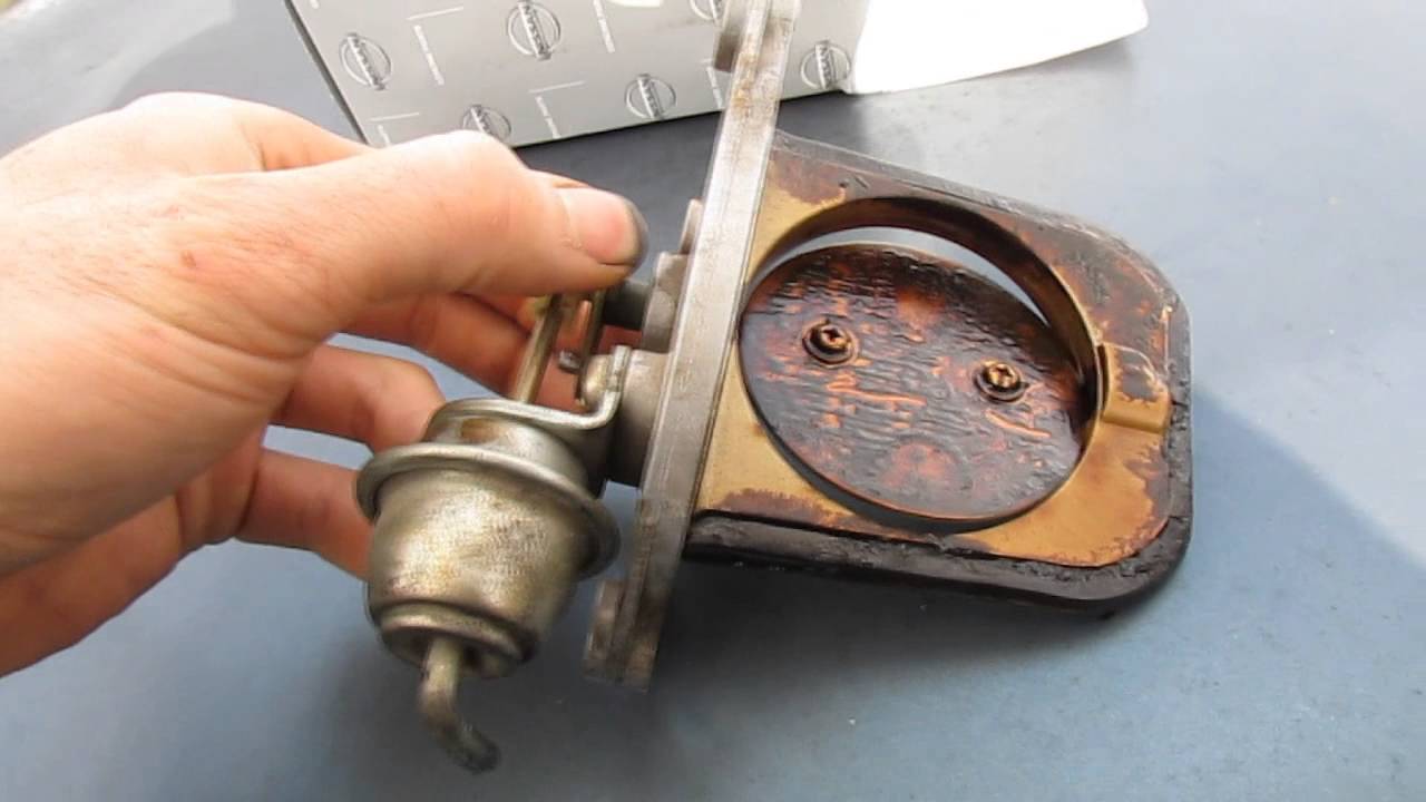

Yeah, it is just a solenoid controlled vacuum valve. Most ECUs have the capability to control such a solenoid based on an RPM window. You could even control it with an aftermarket RPM switch if your ECU could not...but it seems like you are good to go.

Yes these relays can be RPM programmed to do different things, AC, fans, switches, etc.

Mark, the flapper is a butterfly actuated by a vacuum pot, activated by a solenoid valve. Vacuum supplied by a reservoir. A solenoid connected direct to the butterfly arm should work fine.
Do you have examples of the resonance butterfly being controlled directly by some solenoid? I would like to see that as it would save people from installing a bunch of vacuum lines, valves, reservoirs, etc.

Mark, here are some photos where the black plastic intake is a 1995 993 and the alum intake is about an 89 or 90 964. In the closer pictures of the 964 you can see the flap butterfly. Unfortunately I tossed this 964 part when I built a simplified replacement which is essentially a couple tubes, throttlebody, and your good to go. If you integrate a "flap" it was nothing other than a butterfly. Though this 964 part was magnesium it weighed quite a bit. Anyhow it's probably not difficult to find a used one.
Here is a description of the flap operation as written by Steve Wong:
Post from Steve Wong 5-25-2007
Checking Resonance Flap for Operation:
When the ignition is switched on, the resonance flap is closed by vacuum action. When the ignition is switched off, the resonance flap is opened (rest position). The opening and closing noise is audible in the engine compartment.
4. Resonance Flap
The DME control unit activates a vacuum-controlled diaphram valve which either opens or closes the resonance flap.
The resonance flap is closed between 3,000 prm and 5,000 rpm and at throttle opening angle of > 60 degrees.
Due to the ignition sequence, the intake system is alternatively supplied by both tanks. Due to the firing order, air is drawn in an alternating manner from both intake system tanks. If resonances occur, the intake frequency of one row of cylinders matches the natural frequency of the pressure vibrations in the respective tank. The natural frequency is determined by the geometry of the intake pipes, the resonance pipe and the tanks. A crucial factor, however, is the total length of the pipe from the actual intake cylinder to the next cylinder being supplied, the distribution in intake and the resonance pipe lengths as well as the depth of the tank in the direction of flow. In the no-current state, the resonance flap is open. As soon as the ignition is switched on, however, it is triggered and closed. If the DME control unit detects that the engine is being started, the resonance flap is opened again.
Pin 1 from the DME unit is used to control the resonance valve.

Also note that the flapper in the 964 plastic intake setup is open when the solenoid is not activated (no vacuum) while the 1995 993 flapper is closed when the solenoid is not activated (no vacuum).
Well, it could be the other way around but I am 99% sure I have that right.

This is taken form another forum but shows a dyno from working and non working flap on 964 (plastic intakes). As you can see it makes a pretty big difference on the top end power.

FYI a small 12V servo motor with actuating arm on a custom bracket mount can drive the resonance valve on the 964/993 intakes rather than the vacuum pod. This can easily be triggered by most EFI systems using an I/O pin.

I suspect the Porsche Factory chose to use the vacuum system because it was less prone to failure than a 12v servo motor strong enough to move the flapper and able to deal with being activated for long periods of time. A solenoid is much less likely to fail.
I'd like to see a servo motor setup that works and is reliable. Has anyone seen such a setup? All of the systems I have seen with a resonance flapper use a vacuum system. As I said, it would sure make things simpler...

Scott - you are correct on the 993 plastic intake, resonance flap is spring loaded closed.
All others - have a 993 plastic intake with resonance flap and throttle body tube with throttle if anyone is interested.
I saw similar results on my motor as the dyno with res flap closed beyond 5.5k.

So basically it looks like the flap opens at 5500rpm and stays open to my redline. That's easy enough to do.
