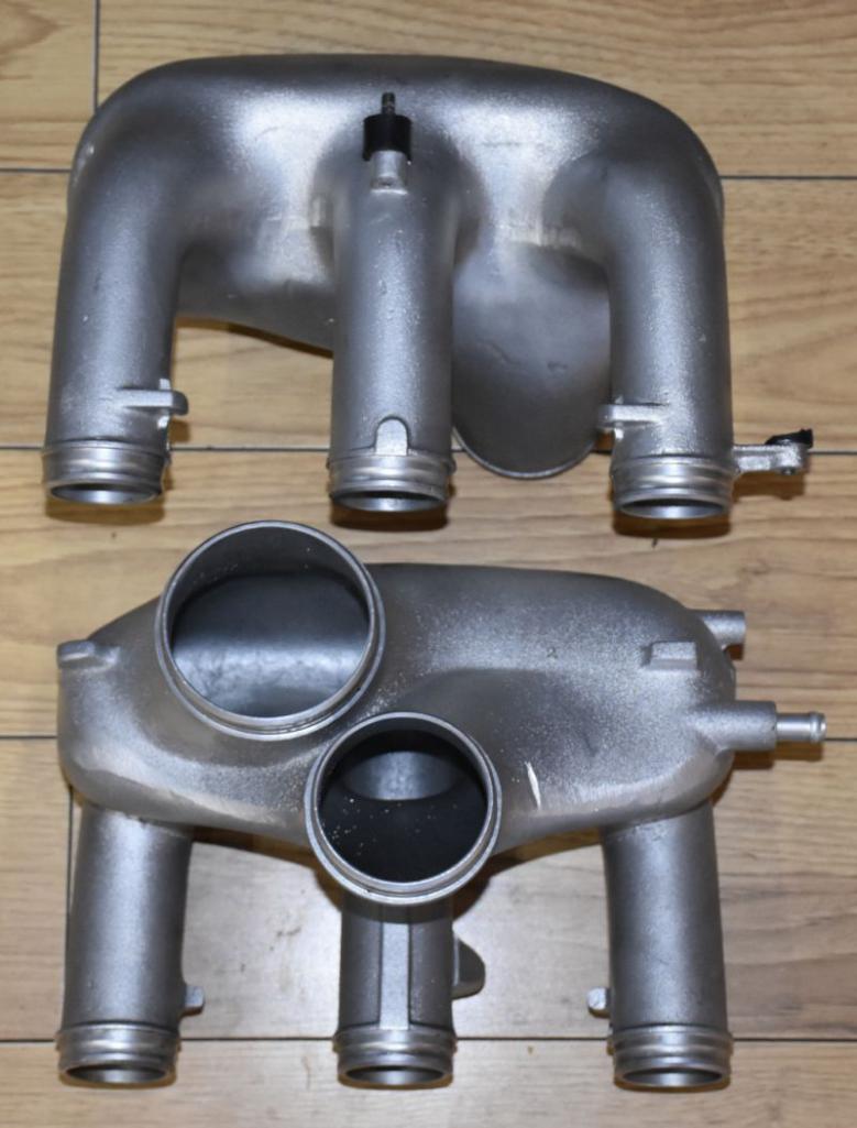

My 964 intake halves arrived last night.
I have to figure out the the stubs and center section details, might take a while as I'm super busy restoring several 914 2.0 Djet engines plus other projects this spring/summer. We'll see how much energy I have left over on the weekends.
A 914world buddy is sending me the stubs and fuel rails, not sure if I will use them but anything to help the design or build is a good thing.
The EFI install itself only takes a weekend, it's the crank trigger and intake fabrication that sucks up the time.
I could buy off the shelf... but where's the fun in that?

BTW I can weigh these if anyone wants, one of the arguments is that plastic is lighter. This likely is true but these manifold halves are pretty light, I'm not worried about the weight for my build.

Intakes look good. Definitely watching and stealing all your good ideas. Ha ha.

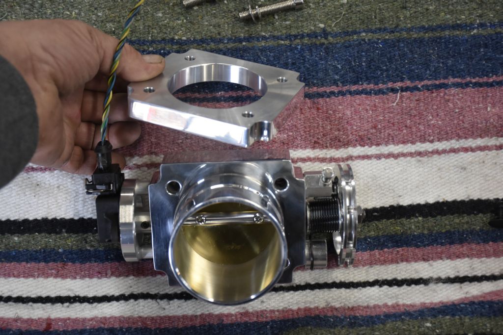

But....My cheap $66 (Canadian with shipping) Ali-express 70MM TB arrived from China today and it looks good enough. This is a universal TB so it doesn't have extra holes and crap. I'll have to figure out how to do the throttle cable as it looks like the wheel take standard bicycle cable ends.

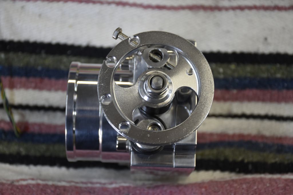

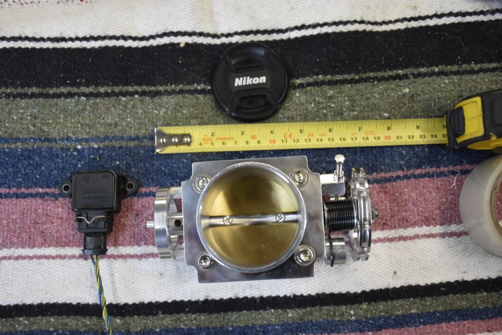

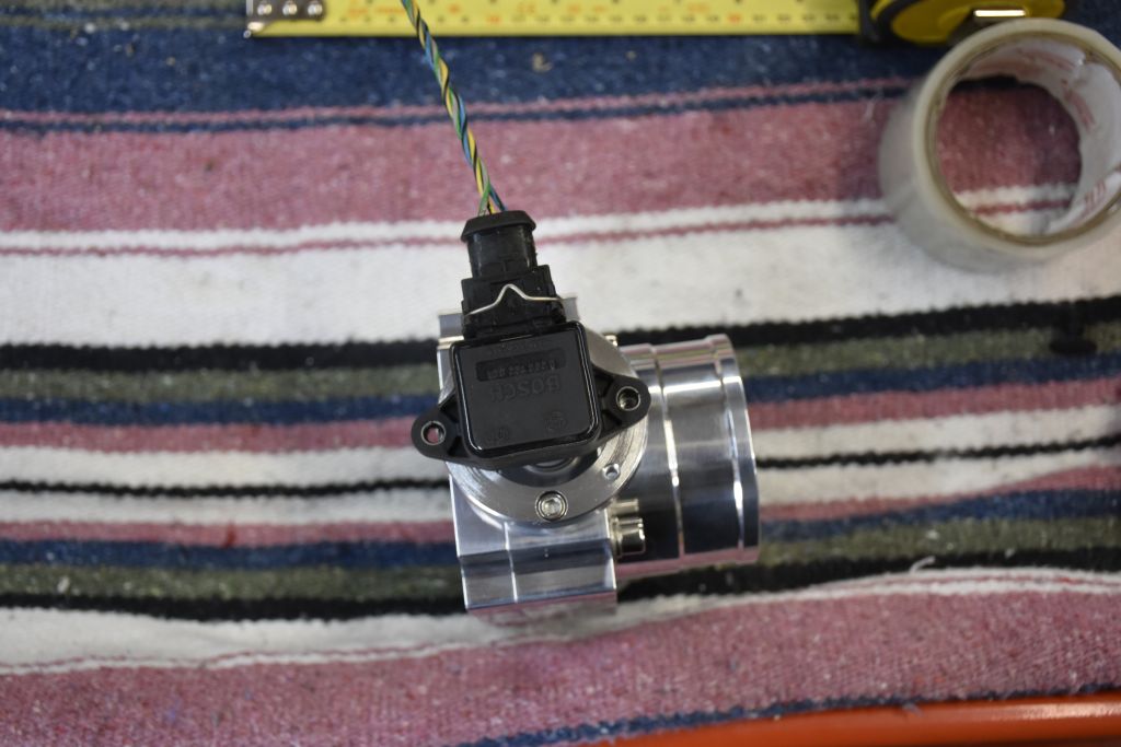

TPS mount doesn't line up with this bosch 3 wire TPS I have, but it fits the D shaft end. It will be easy to make a new mount plate and it will just be a bolt on mod to change the existing mount.
I'll also try a Honda TPS to see if it fits better.

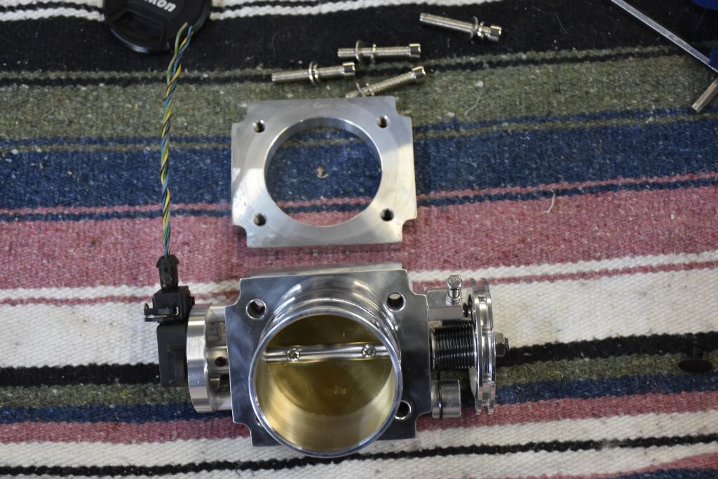

The huge bonus is it came with this 9/16" (1.5cm) thick mounting flange (with bolts) that I can weld to the custom center section I will making.
It has an idle stop, but no idle air bypass screw, so I'll have to crack the plate open a bit for idle or another option is to drill a hole in the throttle plate.

It took me hours of searching ebay. amazon, aliBaba, wish, etc to stumble across this one. I found a bunch of TB's for Hondas, Acuras, Mustangs, etc, but they all had extra crap I didn't need.
This one is a universal TB that's not made for a particular car, I liked it because it didn't have stuff I didn't need.
Basically you'll have to spend the time going through AliBaba searching for "40mm throttle body" then "41mm throttle body" then "42mm throttle body" and so on and so on.
