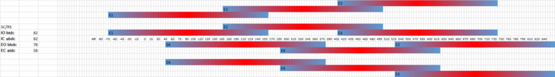

here are some stats for an H6 911 motor at 6800rpm
113rps
57 the # of times each cyl fires/sec
170 pulses/ s into each collector, 0.0059s apart
0.706m distance each pulse travels before the next one enters the pipe
1.3674 pulses in each pipe at a time
here is the mapping for an SC/RS base engine w/ S cams, lots of overlap lats of potential for the 5th cycle gas extraction, there is soo much overlap that the events have to be shown in parallel rather than linearly as in the case of the SC
here an SC, little overlap little potential for 5th cycle enhancement
