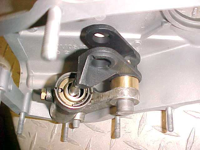

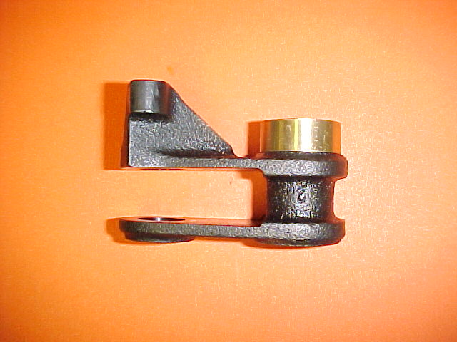

It's hard to tell if you're using wide tensioner/idler arms.
During the early air-cooled 911 days it was thought that tensioners were failing do to heat and poor design.
By the time the factory started using pressure fed tensioners, they had determined that idler arms were binding on the shaft, creating a harmonic that caused the tensioner to fail. They may have introduced the wide arms when they redesigned the 930 tensioner but wide idler arm certainly were installed in all pressure fed tensioner after 1984. The tensioner kits never included new/redesigned arm so most retrofitted tensioner kits were installed using a spacer.
A few years back the left side arm became unavailable so we made a bushing to simulate the wider arm configuration. I liked the modification so well that the one-off prototype became a regular in all of our engines.
We modify stock idler arms and sell them on an exchange basis.
We also upgrade factory wide arms with a propitiatory DP4 bushing for those concerned about wear in their existing arms.

My tensioners were upgraded to oil-fed in 2001, and they have the spacers on them. I didn't buy the car until 2013.
Lee's post about installing them.
I feel uniquely blessed to have this much of my car's history recorded on this forum. And it is amazing to read Lee's accounts of him doing the same stuff I'm redoing 25 years later.

Just to be clear: The pressure fed tensioners without wide idler arms is not the proper way to build these engines. These engines are expensive to build so ignoring modern build techniques is foolish.
