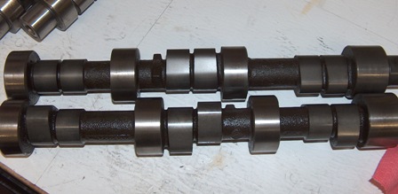

Doing a top end rebuild on an '88 3.2.
After building the right side of the engine I installed the cam as per Wayne's book and notice that the cam drags a bit a certain point in the rotation. I try a few different torque patterns but still the slight dragging persists.
Bummed, I move on to the left side of the engine, but on this side the cam spins smoothly. Out of curiousity I put the left side cam in the right (dragging side) and it spins freely!
Do I have a bent cam, or something different? I had them done by camginder recently(964 grind), could something have happened in the reginding process?
Thanks for any suggestions/help.

Put both cams on your bench next to each other. You will notice the 2 center bearings do not line up with each other. So, by installing the left cam in the right housing, the two center journals are not riding in the housing.
I straighten the camshafts to less than .0005" total indicated run out before I grind them. Unless they were damaged in shipping they will still be straight.
I would completely back off the housing and then insert the cam and check for binding. Should be fine.

Heres a pic of the cam bearing journal locations. Other than removing the right side housing, you can put the right cam in the left housing backwards and the journals will all line up. That is if the soft plug at the end of the housing has not yet been installed.
If you have access to a lathe and a dial indicator you can check the cam for bearing journal run out. Chuck up a dead center on one end and use the tail stock center on the back end. Set a magnetic base dial indicator on the toolholder and spin the cam by hand.

"If you have access to a lathe and a dial indicator you can check the cam for bearing journal run out. Chuck up a dead center on one end and use the tail stock center on the back end. Set a magnetic base dial indicator on the toolholder and spin the cam by hand."
Or support the cam on each bearing end with V-blocks, then measure with the dial indicator.
As racing97 pointed out, it could also be the component stack is not even between the 3 cylinders on the bank. The combined height of each crankcase spigot surface, cylinder base gasket, cylinder and cylinder head must be equal, otherwise the cam housing will tweek (or bend) slightly when the component stack is sandwiched.
