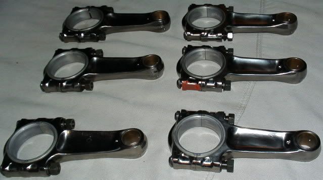

Cool stuff... here are the ti rods and Andial engine stamp on the motor in my 935 M16 .. I opted to take the ti rods out but they were polished as indicated by the paperwork I got from Deiter on my motor...
