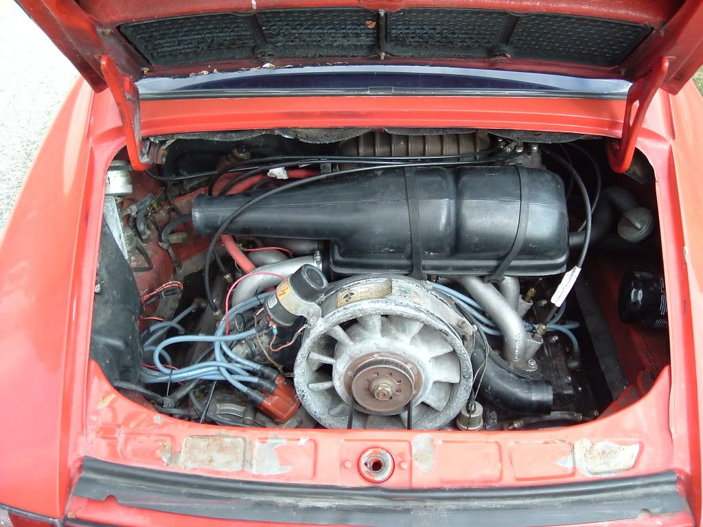

Need 2.7 engine pics
Does anyone have pics of their 2.7 engine. especially from the rear. Can't remember where all of the wires and hoses go. I read Wayne’s book 101 projects too late.

I have some electrical connections I can't remember where they go. I know the blue connector goes to the cold start. Black connector goes to the back of the air box. One gray connector goes to warm up, and they can't find were the other gray connector goes. If you could take some photos of the wiring connections and the breather lines. That would be a tremendous help.

i dont know how much this is going to help but heres the pics of my 2.7. It doesnt look the same now as ive cleaned it up quite a bit but this is all i have...i hope this helps.

Here's my 2.7 patient currently going under the knife
2.7 harness under FI as they lay in place...
and some from a Euro 3.0 also going under the knife...
Hope it helps... Lou

Thanks Lou, Attached is one of your photo's that may clear up my mystery. I hope someone tagged the wires.

I think the one with the "?" goes to the air valve that controls fast idle. It is located on top of cyl #5. Otherwise they look good. Lou

Thanks Lou, Just one more question. Is the connector to cly#5 Black?

yes.... Just found another pix... Lou
