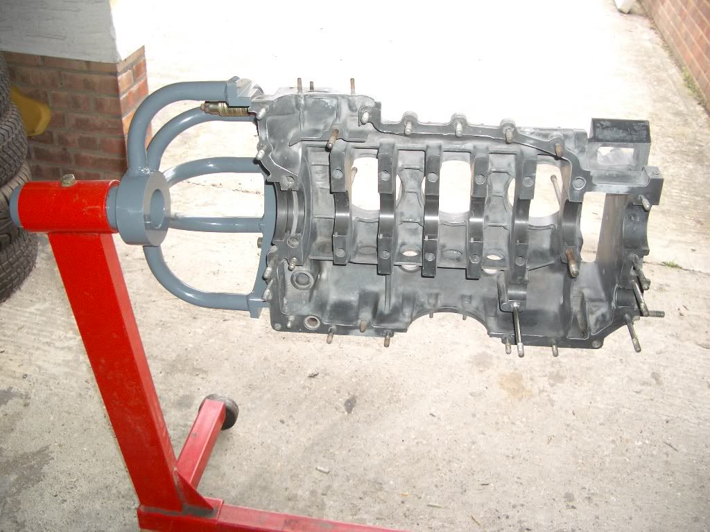

When I get it removed from the engine I have a typical american engine stand. Has anyone use this before successfully?

Wow...sounds like your jumping right in! It might be helpful to read up a little before going to far....it could save you money and headaches down the road. Wayne has an excellent book that I would encourage you to read from cover to cover (it's sold on this site and at bookstores).....One of the topics covered is the use of a stand....I would not use a traditional stand w/out the adapter collar/ring. They are $150 bucks and bolt to a standard stand or you could buy the entire engine yolk... Best of luck to you...ask many questions

Slotcar is right, get the proper Porsche yoke it will make the rebuild easier. Very useful for gearboxes as well.
Since this photo was taken I changed the stand to a twin leg one. Much more stable and should be considered a must.

HI alan uk nice photo of your engine stand/engine holder, i was wondering where you got it from?? .

The yoke is great, works perfectly. To be honest I have not stopped using it.
