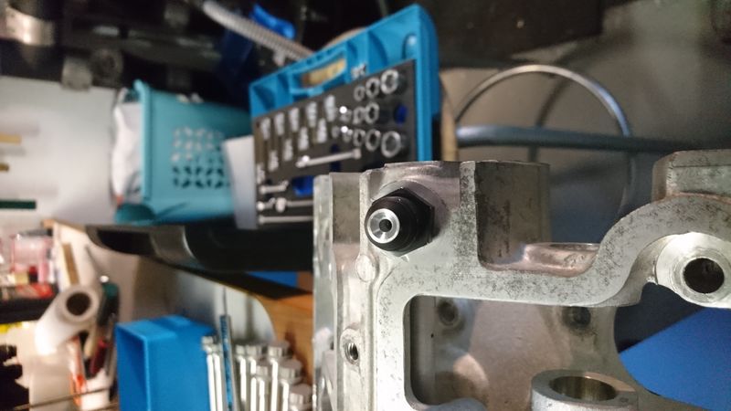

I have Porsche 911 SC 1981 that has a replacement engine that was built by Porsche early 1990. Engine number is 930/10 AT63D6576 (AT=AusTausch=Replacement).
When Porsche built this engine it got few upgrades on from later 3.2 carrera and 964 engines.
-Oil pump is the same that was used in 3.2 Carrera
-Hydraulic chain tensioners from 3.2 Carrera
-Camshaft housing from 964.
But Porsche did not use the restricted oil flow fittings on the camshaft housings. I don’t know why.
Yesterday I installed these 2.5mm restricted oil flow fittings to my 1978 930 turbo engine that I’m rebuilding. This engine has GT3 oil pump, front fender coolers both left and right side. Engine mount oil cooler has been replaced by 965 oil filter console.
So let’s see if I want to open these up or not based on this thread.
