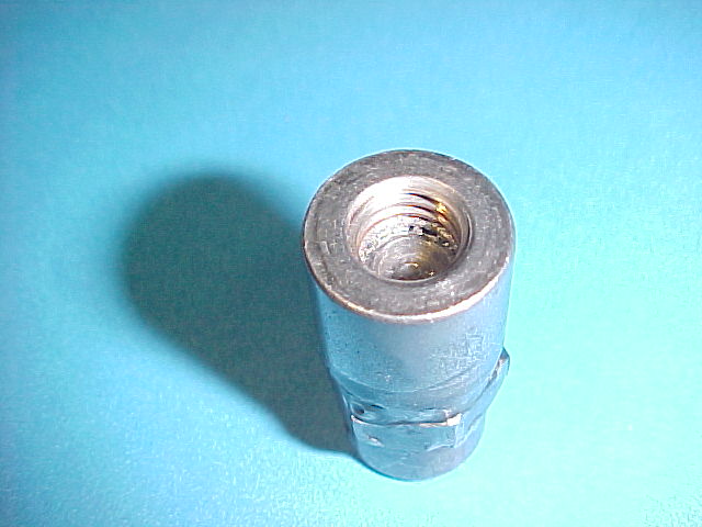

Here are a couple of stud installing toosl that we use with regularity.
The 8 mm installer is made with 1 911 exhaust nut, one ball bearing and one 8 mm cam tower nut. The ball bearing is pressed into the exhaust nut and the 2 nuts are them welded together.
For the 10 mm stud installer we use a 911 head nut , a 10 mm hex nut and a short 10 allen bolt. You thread the nut onto the allen bolt then into the allen end of the head nut. Then just weld the pieces together.
Use a good quality anti seize in the installer and go to town. It take a little effort to make these tools but once you have them in your tool box you'll be amazed at how often you use them.

Henry, that is almost too cool for words. Thanks for posting! Turns out I have a whole bunch of those nuts around and will take a stab at it. I like the fact that it's got a small OD so it will fit down in the fins.

OK, I obtained a japanese-made stud remover that works on the same principle Henry outlined- rather than a clamp on the threads, this puts tension on the end with an internal screw. It worked fine, so well that I ripped out the zinc-plated studs and replaced them with black oxide.
The ends are different from the original DIN studs, if I lose a point for that I'm going to convert the car into a 911R.
Well, I learned a lot about studs in the process, time to move on to the pistons and cylinders. . . I'll start a new thread for that.
