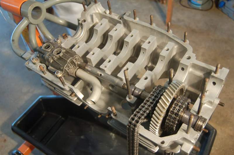

Ok, 911SC Oil Pump in place, oil pump seal in case half already. I stuck these down with a TINY dab of Curil-T, don't worry. I did NOT use prevailing torque lock nuts even though I had some. . . how would I know correct preload without measuring stretch by approximating a torque if the deformed threads require a huge torque to lock the nut? So it was lock tabs for me. The oil pump was disassembled and cleaned, somebody had dimpled the gear teeth to indicate which mated with which, I'm not sure if the factory did this. There was a surprising amount of debris inside the pump, even though I had run it through my ultrasonic cleaner first. That all got cleaned out, I was tempted to surface the housing on my surface plate to reduce the end clearance on the gears, but as it's a street engine I left it alone. I torqued the M6 bolts (10mm ATF) on the pump body to the generic spec and applied red loctite for insurance. The pump spun freely prior to assembly, no problem, and I filled it with Aeroshell Fluid 2F with a squirt bottle and spun it a few times. (Aeroshell Fluid 2F is an anticorrosion aviation oil designed for engines that are not turned over in wintertime). Intermediate shaft assembly spun freely although it was a challenge holding the chains on. Ultimately I safety-wired the chains in place.
Next photo: this is my thrust bearing, note the slots all the way through. I know this differs from the factory bearing, this is a Glyco. We'll see if there's any difference at the next rebuild.
Crankshaft installed in case. I used Three Bond 1211 to glue the outboard half of the Number Eight main bearing into the bearing saddle. It needed to be seated in the case slightly with a mallet, the bore was checked and was fine but I heeded Henry's suggestion to glue it in place. I left the back half open for the o-ring and the oil pressure relief groove. Pulley seal was installed DRY, no Curil-T, just a thin coat of Fluid 2F on the nose of the crank to allow it so smoothly go through the coil spring.
Intermediate shaft backlash? WHAT intermediate shaft backlash? I couldn't determine there was very much at all. Now, this is the original intermediate shaft "O" gear and the crank came out of a '69E which also had a "0" gear I believe. So I'm chalking up the lack of backlash to the very cold temperature of the case (about 45F) on assembly. We'll see if there are any issues. By the way, finding a way to setup for the measurement was a huge pain in the rear, somebody should design a jig.

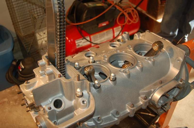

Here we go, chain props in place, just about to put the oil pump seals and case-to-case seal in. By the way, these look the same as the oil pump seals (3), there's just one big one and three smaller ones compared to the one big one and two smaller ones for the oil pump. No big deal, just make sure you don't forget them.
In this photo the assembly lube on the bearings and the 574 have just been applied and the stopwatch started. The case was assembled and torque begun inside 10 minutes and all torque was complete at 45 minutes after the 574 hit the case. Note that I used a very thin bead, and did NOT use any on the main bearing webs. I also put the sealant on the LEFT case half only.

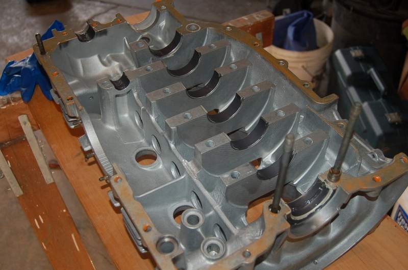

Next photo shows installing through-bolts with the nuts on the same side of the case as the other nuts, this is the way it is in the factory workshop manual. Wayne's book has a diagram for the torque sequence, but it's hard to follow if you're not on the same side of the case. Somebody suggested marking the case with the torque sequence, this isn't a bad idea, although we were able to do it by calling out which one to put the breaker bar/15mm socket on so it wouldn't turn.
Ok, here's one to pay attention to. When I was torquing the case perimeter nuts, two of the studs at the aft bottom of the engine were taking WAY too much effort to get the wrench to click. All the studs had the same black oxide coating with a thin coat of oil wiped off. So I'm torquing away and I hear this sickening "pop" and immediately realize that a stud has failed. I shrug it off and go on, the 574 is setting. The next stud. . . POP! Some execrable Prior Owner probably tried to fix an oil leak in this area by overtorquing these studs. . . so they failed! And the heck of it is, there's just no way to tell, I couldn't measure the installed length of the stud and didn't see any obvious signs of over-stretch e.g. necking down. So if you want to be safe always, change your 41-year old studs! Another stud at the top of the engine was also experiencing plastic deformation that I could actually FEEL- so I stopped before it broke and removed it. You can see it in the photo below.

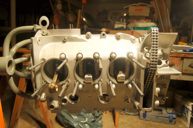

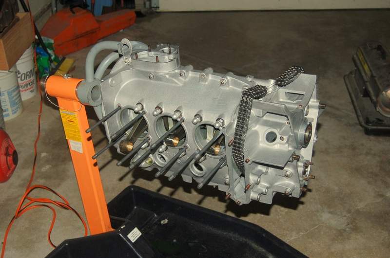

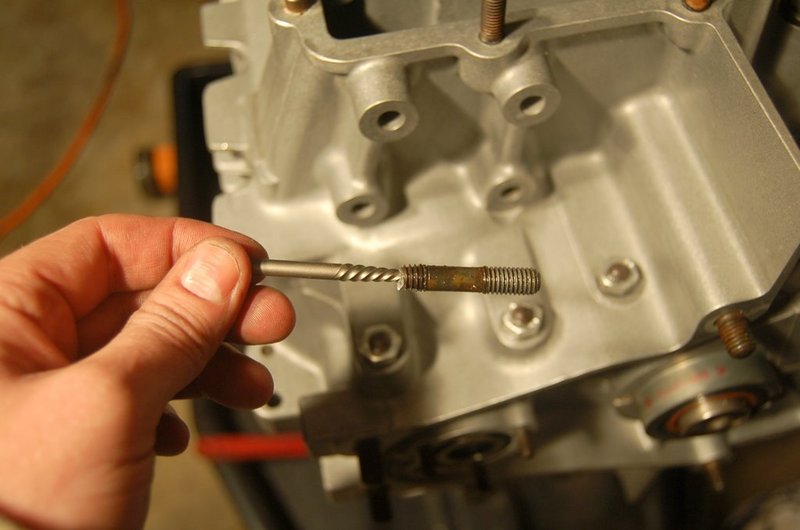

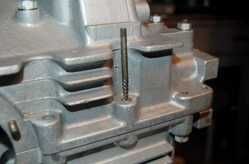

So I took a hefty bag and put it over the engine and put a small hole over the stud so as not go get chips in the engine. I put a punch mark at the approximate center of the jagged stud and used a dremel tool with a 2mm drill bit, first on 8000 rpm to start the hole, then on 2000 rpm to drill it, with plenty of PB blaster for lubricant and to loosen up the stud. I hammered in an EZ-out and turned it with an adjustable wrench (I don't have a tap handle yet). And I'll be a monkey's uncle, the stud came out! Next photo is of the removal of the adjacent stud, hefty bag removed for clarity. A double stroke of luck indeed!
The money shot. I have never turned a wrench so carefully, as so many times when I've tried to do this, the damn EZ-out breaks off, or the stud cracks in half, or Bernanke changes interest rates or some other crap happens.
Ok, this next photo is just the engine case assembled. You can see the missing stud at the top. I don't think this is going to cause an oil leak, there was no gap between case halves at the top, I used 574 to seal it and the adjacent studs were torqued to spec. Likewise at the bottom, when I replace the studs I'll torque to the correct setting. Ordinarily this kind of damage would require that I tear the case back down, but I was able to remove the broken studs so I'm going to proceed as normal, worst case is the engine will leak and I'd be in the same position of having to tear it down again. (Of course the top end would have to come off but there's a procedure to do that in chunks.

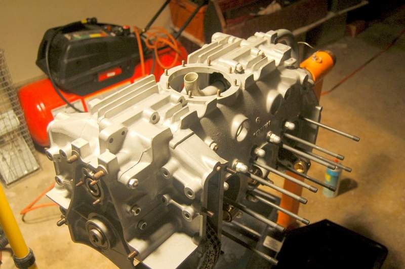

Next, I started installing head studs. Two of the studs would NOT go in with finger pressure with the long threads lubricated with red loctite, so what does the monkey do? The monkey forces them! So then I broke my Japanese-made stud remover trying to get them back OUT. ON went the hefty bag and OUT came the Vise-Grips, the only tool a monkey needs! That and the Pelican Parts web site to order TWO new replacement factory steel studs. And while I'm at it, a correct Snap-on stud remover/installer, I should never have tried to save money on that item, and a M10 tap to clean out the holes. I think some ZoopSeal got in the holes and hardened, the threads were perfectly clean before I did that step. You can see the two missing studs.
I only had time to do one side, but I'll clean the holes carefully with the tap, no doubt the ZoopSeal blocked some of the upper holes here too.

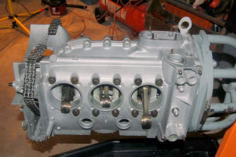

Ready for the rest of the head studs, three replacement perimeter studs, and then it's on to pistons and cylinders.
What did I learn? A helper is invaluable in the process, it would be VERY difficult to lower the case down accurately without one person to lower it down and one to spot that the studs are aligning correctly. Also, somebody to hold the crank when the rods are torqued is useful unless you are using a factory-style jig to hold the crank between bench centers.
I didn't push the 574 setup time, through-bolt torque was applied inside of 10 minutes. One step that was helpful was preassembling all the through-bolts with washers and o-rings and Dow Corning 111 (no RTV for me) in advance. I used the cap of my Sharpie with the clip filed off to make it smooth, this was placed over the threads to allow the o-rings to slide on over them without getting sliced. Also, you wouldn't think it would work once the through-bolts are poking up through the case and there's only thread sticking out, but it actually worked extremely well. Thanks Jon for the tip!

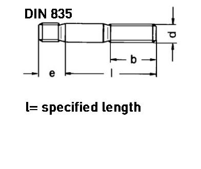

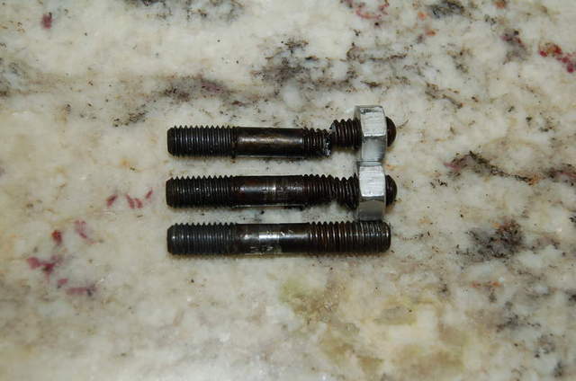

Here are the broken studs.
length 50.7mm
length of long thread 19.5mm
length of short thread 16.5mm
Now, the PET claims these are BM 8x35, the original Parts Manual lists these studs as BM 8x35 SN 1115 DIN 835-8G phr. That means a metric stud, nominal diameter 8mm, 35mm protruding length. . . hold it a minute.
DIN studs are described NOT by the overall length but by the length of the stud that would ordinarily protrude from the surface into which it's inserted. Wow what a sentence, try translating THAT into German.
Anyway, there are really three parts to the stud:
the short threaded portion or "tap end" (e in diagram)
the unthreaded portion
and the long threaded portion or "nut end" (b in diagram.)
The "length" measurement of 35mm in this example refers to the length of the nut end and the unthreaded portion, shown in the diagram as "l."
A few more rules of thumb for DIN studs. Generally, the length of the tap end e, is, for a DIN 835 stud, 2.0x the nominal diameter of the stud. So for an M8 stud, the e is about 16mm, pretty close to my measurement. For DIN 939 the multiplier is 1.25x, 938 1.0, 940 2.5.
A guideline for calculating the nut end b is, for studs whose l is equal to 2x their nominal diameter but less than 125mm, then 2.0x the nominal diameter plus 6mm. So in my case M8x2 = 16mm +6mm is 22mm. I measured 19.5mm, not exactly right, but a little more length we can live with (as Bruce Anderson would say.)
So I'm looking for a DIN 835 stud with an l of 35mm. This would imply that the tap end is 16mm, the nut end is 22mm, and the overall length around 51mm. Let me see what I can come up with.

Chromium plating of headstuds? I have never heard of this process. Chromium plating is usually used for appearance purposes or occasionally as a wear surface for cylinder bores. If anticorrosion resistance is what you desire, I would have the headstuds plated with Zinc. Observe post-plating heat treatment as well to prevent hydrogen embrittlement due to the acids used in the plating process. My headstuds (steel) are black oxide. Dilavar is a conductive metal so it should electroplate but I cannot predict the effect on its mechanical properties, you are a test pilot! I personally would not take any risks with these critical components because of the difficulty of replacing them in the event of a failure and the comparatively limited reward offered by improving their properties.
