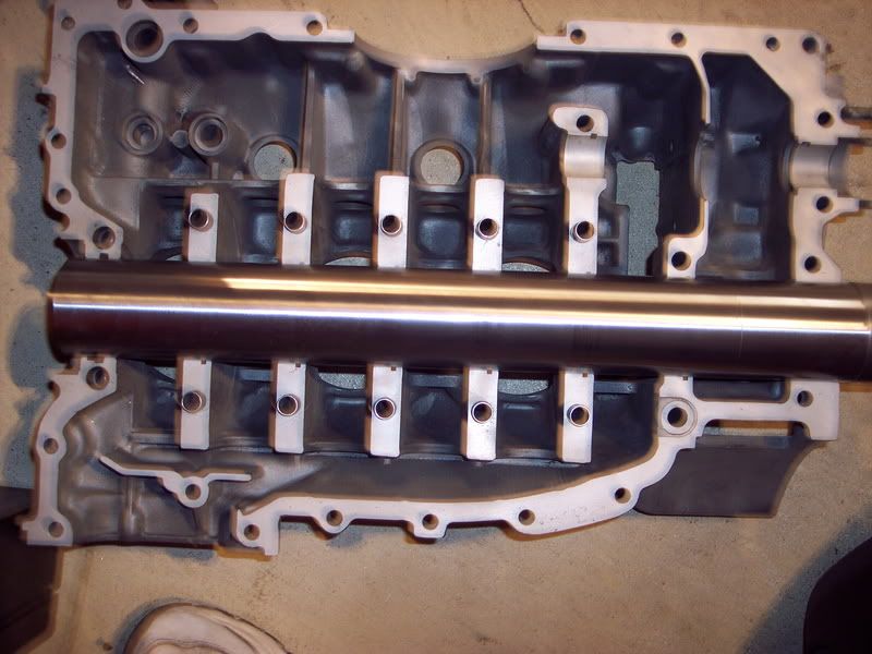

A little update: I wanted to make a test bar for the finished case rather than checking it with a new set of bearings, This is what I came up with: Turned and ground a bar to 62mm 20" long to fit the case, this will also be useful for the jig when installing the additional alignment sleeves on each main bearing web:
That's outstanding!
What's that checking bar weigh?

You made me dig thru the basement to find that thing! 508x62mm 26lbs

That huge checking bar presents a great opportunity to gather a piece of data that we don't have.
What is the distance between the spigot height and the bar? You could measure with a depth mic. Or with a simple caliper cross a straightedge placed across the spigot.
The 356 guys have this spec, I know we use it when cases are resurfaced, but I've never seen it in print. This will help establish the distance between crank centerline (half the diameter of the bar) and the spigot height, which together with cylinder height will help us understand the geometry for deck height. Not that we can't set it now, I just have never seen the spigot height number published.
I realize you may have to dig out the bar again. . . counts as excercise. . .
