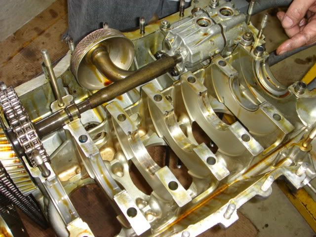

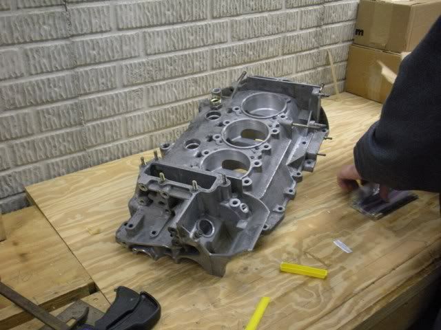

Split the case. Packaged up rods, cylinders, and pistons. Pretty much done, except for replacing head studs and cleaning everything up a bit, for about 3 weeks until we get everything back...then the fun begins. Here some pictures of the internal disassembly...

Rick I see you left the crank pulley on. It takes a lot of torque to remove the bolt.
Good luck!

The crank pulley was already loose, just there for protection.

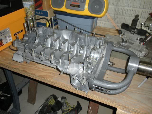

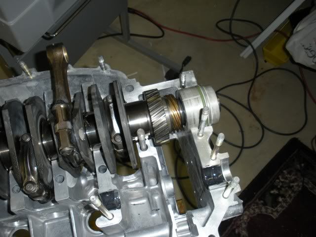

Just an update - crank is assembled and started cleaning on case
Here is some of Competition Engineering's work - very nice!

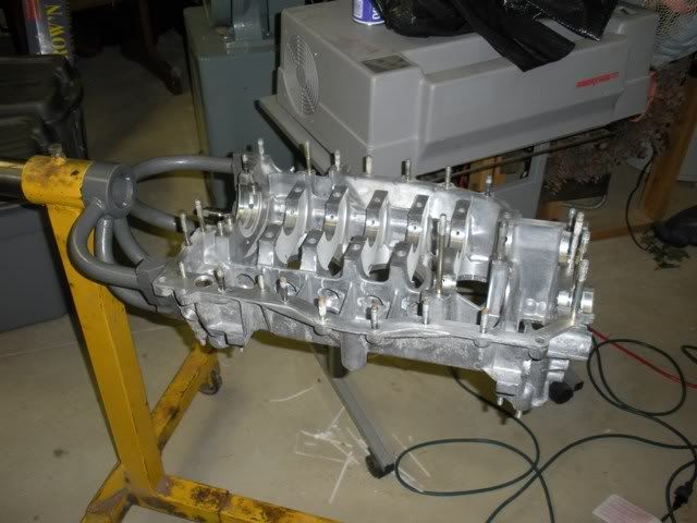

Hey guys, just started engine assembly today. We were able to get the engine case back together and everything torqued down. We're hoping to get this car back on the road this spring/summer. Having it in the garage for almost 2 years now is really killing my dad and I.
Here's some pictures of what took place today...
