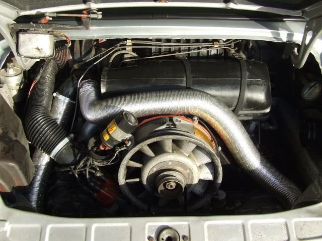

Trying to identify an engine, engine number is 6378840 - what is it? Could someone explain what the numbers stand for please. Also is it originally from a car with this chassis: 911531xxxx
Here's a pic of it:

hope someone will chime in for you and tell you if its ROW or US but just from looking at it i see a red fan shroud, CIS, metal fuel lines so im guessing a 80-83 3.0 SC engine.

you will need the engine type No' it is just behind the engine No' and should start with 930/xx, the engine No' looks like a 1977 engine?? with the wrong/late injection on it.

from the engine No' you have there it looks like a 2.7 engine , you will have to get the type No' to confirm which engine it has. I have been talking to Bert about the car and he has info on it and has been to look at it some time ago, I can give you his No' if you like and he is in the area this week.

The engine number is 930/10

look on the link, as it is a 81 SC engine??

HI again, the engine No' should read 631 8840?? would you check that the "7" is actually a "1" and then it will tie up OK as a 1981 engine, and not this,
