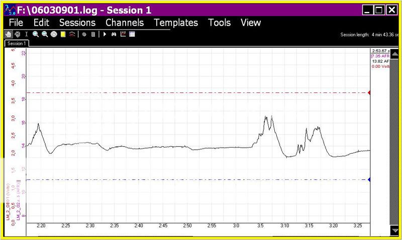

Shall check the WUR and TTS today, earlier I checked my car driving with thr LM1 and the AF seems ok, the car runs very fine on throttle so that was not a surprise.

+ 30 minutes.. ... just drove home from my hobbygarage, car run like sh***,.. well so much for mix and match. Tomorrow I will reverse to the original air flow sensor and do it by the book.
Check the fuel pressures
Check all connections for vacuum and clean out the WUR ( took of the oil cap on idle, no change in Rpm's )
Will also test the A/F ratio under various rpms and under driving condition, for what it is worth it does not seem to be possible to get a steady A/F ratio with the CIS system but if it gets around 14 - 14.7 under normal operation it would be nice.

I'd love to see A/F ratio curves from anyone that would happen to have it.. my curves for hot engine were good but on cold start it is only the pop valve that has saved my airbox (its backfiring).

I did run the engine with the LM2 and received 13.9 - 15.2 air fuel ratios and the engine seem to be more happy with the current setup. The AFR seem to be good.
