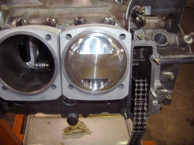

Good day to all;
I was reading my copy of the Porsche 911 Performance Handbook. On page 170, there is a list of piston and cylinder sets for different 911s, including oversized combinations.
It lists a 3.0/3.2 oversize to 3.8L piston/cylinder set (100 x 76.4). I've read quite a few on 3.4 conversions. There is less information on 3.5 conversions... and I've yet to see someone who has done a 3.2 to 3.8 conversion.
Has anyone ever seen/done this. Are these piston/cylinder sets still in production? I can't seem to find sets specifically to oversize a 3.2. I was able to find 100x76.4 3.8L sets made by Mahle and JE Pistons, but they advertise them as 964 oversize kits. Are these compatible with a 3.2 core and would any additional modifications be needed?
Here is the link to JE Pistons website, look towards the bottom:
http://www.jepistons.com/Catalogs/Automotive/Porsche.aspx
3.8 102mm 76.400 Compression of 11.5 (Kinda high for North American gasoline, no?)

Of course it can be done.
Specs are:
Based on a 3.2 case – boat tailed
3.2 74.4mm crank stroked to 76.4mm Re-nitrate
Using 2” rod journals utilizing NASCAR type rod bearings.
Center drill for better oiling to #2 and #5 rods (special center main bearing) engine will be able to turn to 8600 rpms, but we are holding it down to under 8000 rpms.
Custom Pauter Connecting Rods – using Raceware Hardware
Camgrinder -DC62 profile on a 108° lobe center
Race Springs, Ti Retainers
3.2 Heads – Dual Plugged & Ported
102mm LN Nickies 11.3 to 1 CR
JE Pistons coated
52mm ITB’s big injectors – FP Regulator (plus all kinds of other stuff)
Smart Racing Oil Filter Console
1¾” Nabel’s Headers into an (M&K Sport Muffler for street) M&K Shorties on the track
Spark and Fuel controlled by Haltech E-8 Engine Management System
Crank Fired Wasted Spark Accel Coil Packs
Light weight Al flywheel and HD clutch
Mike²
1985 M491

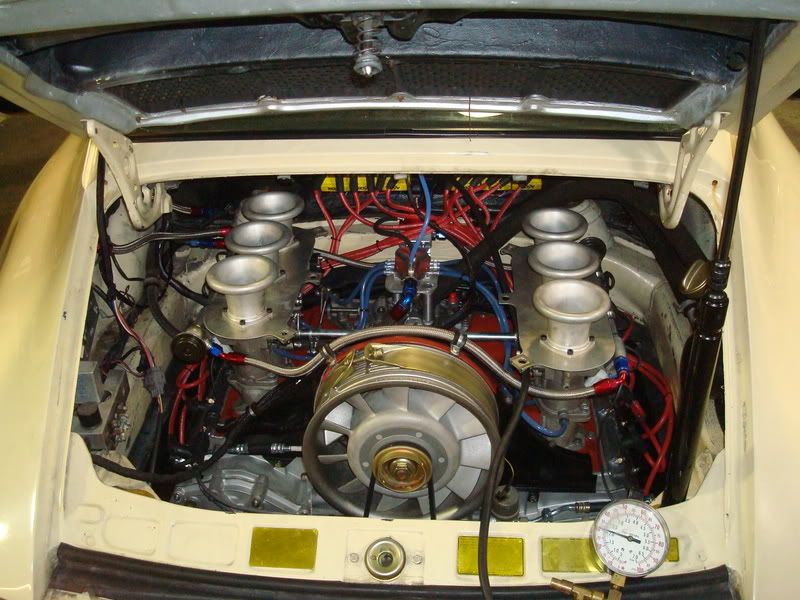

Thanks guys, The real genius behind the 3.8 is Bill Rudtner. We collaberated and he made ithappen.
The engine did 365 to the rear wheels, with a 15% drivetrain loss I believe we were looking at 415 crank.
I had Bill make a less aggressive street map to be more user friendly on the street.
Due to health issues it has become more difficult to attend track events, but I hope to get back soon and use the more aggressive track mapping.
Oh yeah, it pulls like a freight train to 8600 rpm.

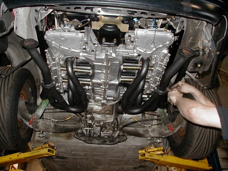

Mike, What is the exhaust setup like on your 3.8??

Headers are George Nabel's European Racing Headers in 1 3/4" with an M&K Sport Muffler

Nice setup.
But headers in the second picture might have been put on the wrong sides.

I think the responsiveness on the street would be to use a more moderatley sized ITB.
I'm running 52mm. I am thinking of dowsizing to 50mm or thereabouts. I have yet to discuss this with the builder.
Since my direction will now be more street than track, I think a smaller ITB would be called for.
Drivability on the street, (as is) is like driving a bucking bronco.
BUT, when she catches.... hold on!
Mike²
