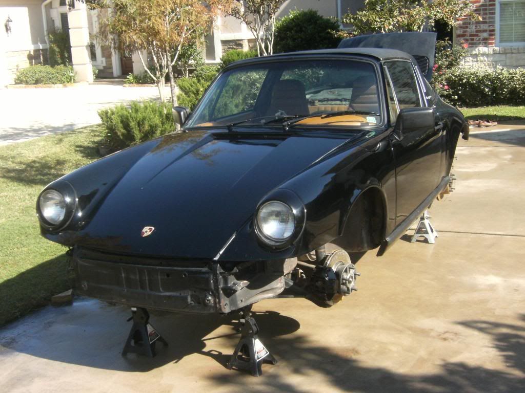

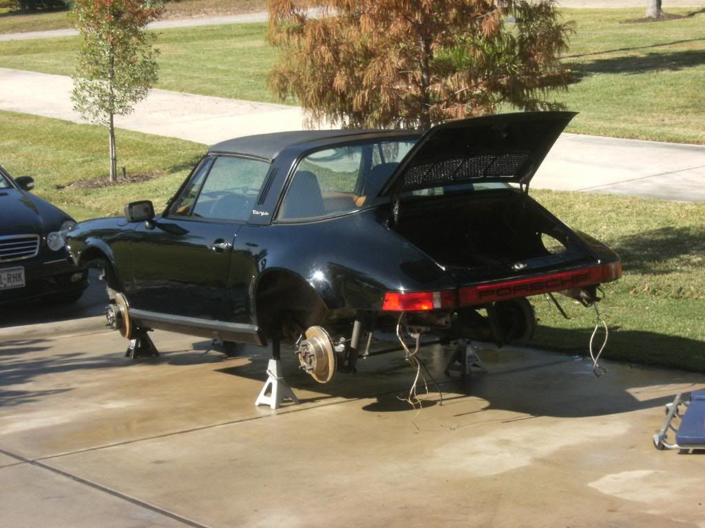

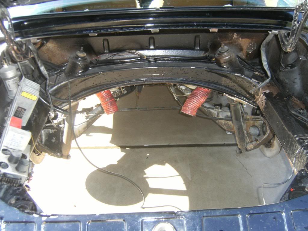

While the parts are being serviced in various parts of the country, I thought it would be a good time to get the pressure washer out and irritate my neighbors. Lots of gunk in the engine bay and wheel wells. It looks a lot better after P-wash! I will re-paint the engine bay, fender wells and freshen the bushings all around. Turbo tie rods and re-built calipers on new rotors. Piston and bearing photos this afternoon.
