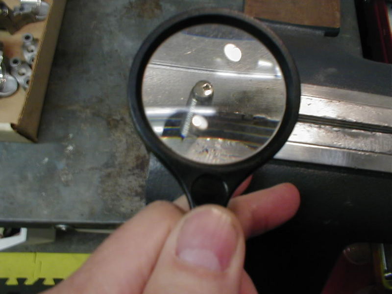

I copied this off the web...
Not sure if its true, whats the opinion?
The Problem with Using a Feeler Gage
In reality, the rocker smashes against the valve stem like a hammer on an anvil. It does so 25 times per second at 3,000 rpm. Although both are hardened steel, eventually the elephant foot and the valve stem wear, necessitating adjustment by means of the adjusting screw. Unfortunately, the rocker arm, which to account for tolerance build up is larger than the valve stem, tends to suffer concave wear to the center its active surface.
To adjust a valve clearance, a feeler Gage is usually placed between the valve stem and the rocker.
When the rocker tappet has worn, the measured gap, which is the thickness of the feeler Gage, is less than the actual gap, the feeler Gage failing to measure the concave wear point. This results in the valve opening less than it should, (adversely affecting performance), slightly off valve timing and above all, very noisy tappets.
Could adjustments made by using thread pitch and degree work better on worn (seated-in) parts?
I did a valve adjustment this summer, I did the intake first (cold) ran the engine up to temp on long spirited drive came home dumped the oil to get ready to do the exhaust next morning. I set one valve hot to see if temperature made a difference in gap, the next morning the valve I set hot had no rocker movement at all from the slight play (free float) to a bind. Say from .004 to .000, So setting @ .004 cold most likely goes to .008 hot.
Bob

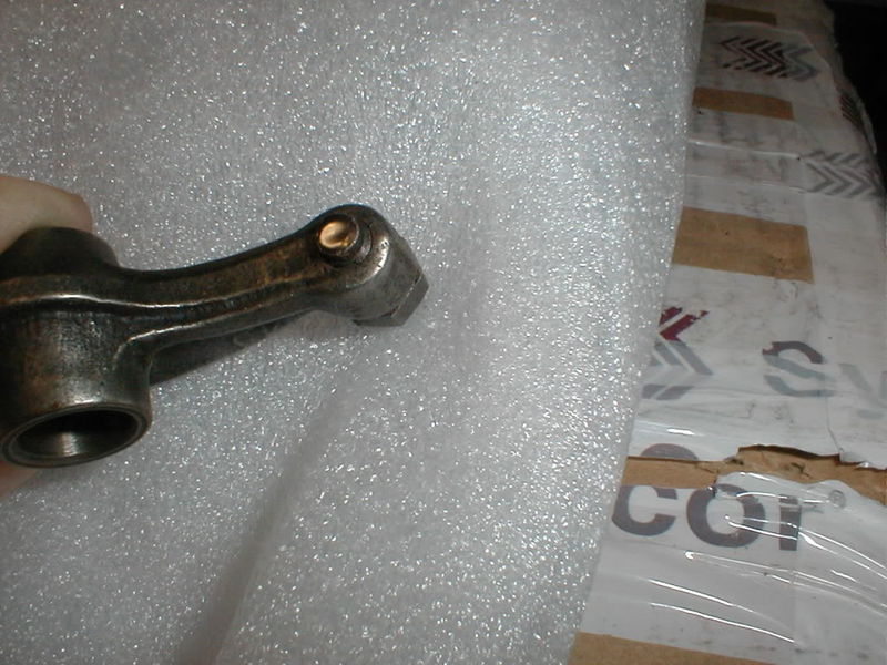

un-measured gap! My best rendition...

This is off a motorcycle engine, excessive ware on both valve stem tip and swivel foot. Clearly a feeler gage would not measure the valve lash well. The poster of the pics wrote that a .004 was more like .008. Adjustments that are to loose hammer valve stem ends, swivel foot and valve seat.

Bob
Nice pictures. Wish I coult get my modest camera to focus through a magnifying glass! If I could, I'd supply shots of some random valve stem tips. Not a scientific sample, just what is sitting on my desk. None look convex. From memory, none of my elephant feet have been concave, either.
Others, and some certainly have a lot more experience than I do, may have seen cupping of the elephant foot, or of the tip of the valve stem. Your motorcycle engine being one example. But I never have with my 911 motors. I've had an elephant foot ball tip break off, and had a couple bend at the waist, all due to overrevs. Otherwise, anything that will screw out OK I have not hesitated to reuse, and have not gotten myself in trouble with this cavalier attitude. The valve tips I looked at look fine, despite fairly high mileage on some. Only ones which look beat up came from engines which blew up, as evidenced by dents on the valve head faces. And those don't even look bad - nothing you couldn't true with a valve grinder.
Maybe on some engines this is an issue. Not on my 911s not reved over 8,000 rpm, anyway.
There are lots of things one can worry about in life. Porsche 911 valve lash should not be one of them. Feeler gauge works just fine. Factory says to use it, which should say something.
But for those who are inclined to fret, there is the back of the cam method. And one can just set up a dial indicator and do it that way. Both would take care of any concavity issues.
