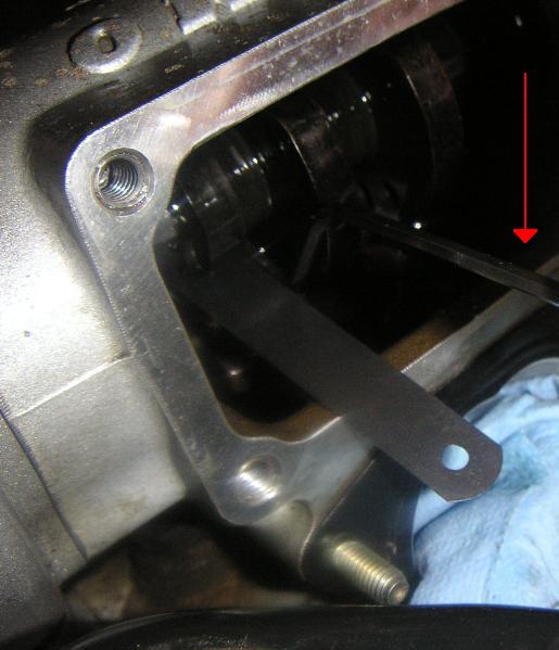

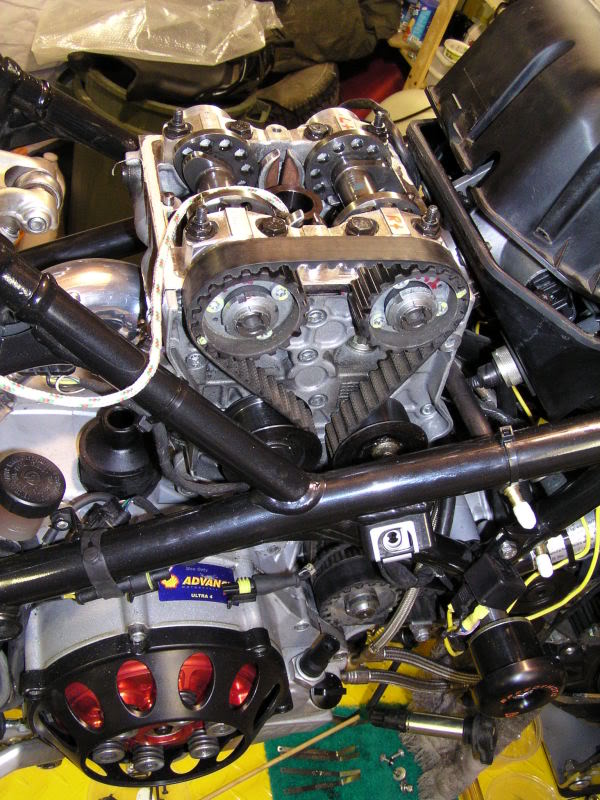

Ducati Valve Adjustment
Compare that with this: 4V Desmo Adjustment - Ducati.ms - The Ultimate Ducati Forum
Unfortunately, many of the photos are lost in cyber space, but here are a couple:
and a video: YouTube - cjayheff's Channel
Only the Italians could design a system where you must remove the cams and finger followers to change shims and valve lash.
Don't drop a valve (into the cylinder) if you are doing this with the heads on the engine.
