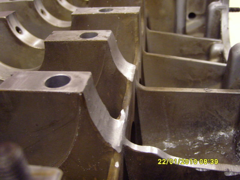

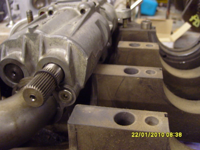

HI kenikh
you just need to make the No'3 main the same profile as the No'2 main as the photo;
to clear the oil pump case and clearance round the pump, 964 pump in a 7R case;
please do not use a grinder on the mag case, a linisher/belt sander or a diegrinder with a corse cutter, as I have found hard bits in the casting and have been told the Mag'will set on fire easly, it has been known.
regards mike

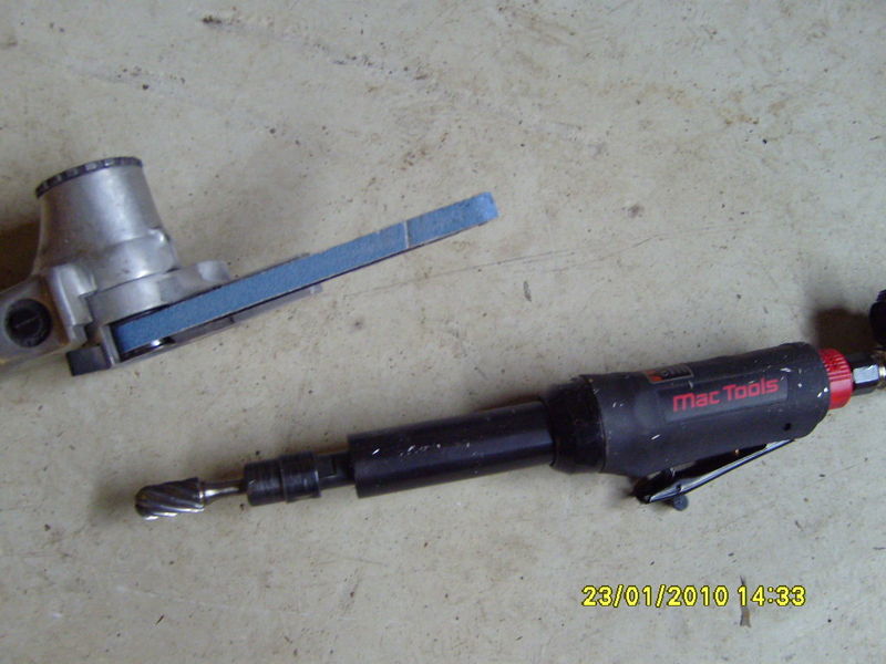

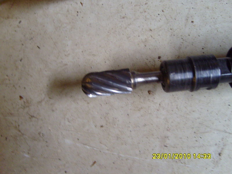

HI kenikh
tools ahould be OK, should take you about 20min to sort, di-grinder and cutter like this?
and a small linisher to finish off,
just watch out for the hard bits, some times in the casting, not alway's, but some times.
regards mike
