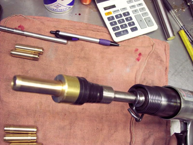

I just got a set of heads in to do so shot a vid of sizing the guides, may be kind of dumb but I like pictures!

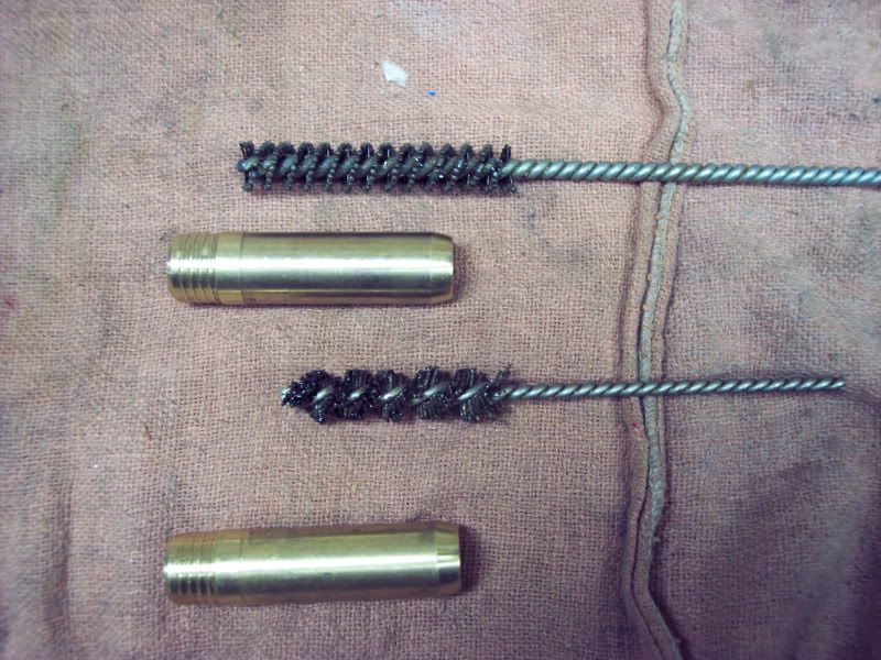

Post installation, do you hone or ream the guide bore ?? - I've not seen the honing tooling or process on holes this small (8 or 9mm)

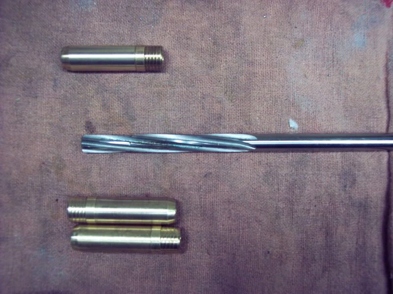

John
John: I use both, ream then hone, I have two hones, a small ball and brush hone, I actually like the brush better it does not hone as quick. You really have to ream them to cut the guide straight on all sides after its installed because it will crush a bit. To install them I just use my air chisel and made a tool with a depth gauge on it. They go right in but make sure to use some lube or it will never go!

Good idea with the air chisel. Does the fsm call for baking the heads in order to install the guides?
85 (early) 944
78 sc targa
"The fool who wades in doubt will float like concrete"
Old 02-26-2010, 02:16 PM
abit off center
cgarr's Avatar
Join Date: Feb 2002
Posts: 7,311
Only for seats.
cgarr,
What's a good grit and size hone for the valves? i've seen 9, 9.5, and 10 mm and all have various grits.
85 (early) 944
78 sc targa
Old 03-03-2010, 07:33 AM
abit off center
cgarr's Avatar
Join Date: Feb 2002
Posts: 7,311
I like the 240 Grit, Ideal for Precision, Final Fitting of Valves to Guides

Do you think the 9mm hone would be too small to effectively hone the guide? Would the 9.5mm work better? I also read that people use lapping compound during the honing process. Do you think it's necessary?
